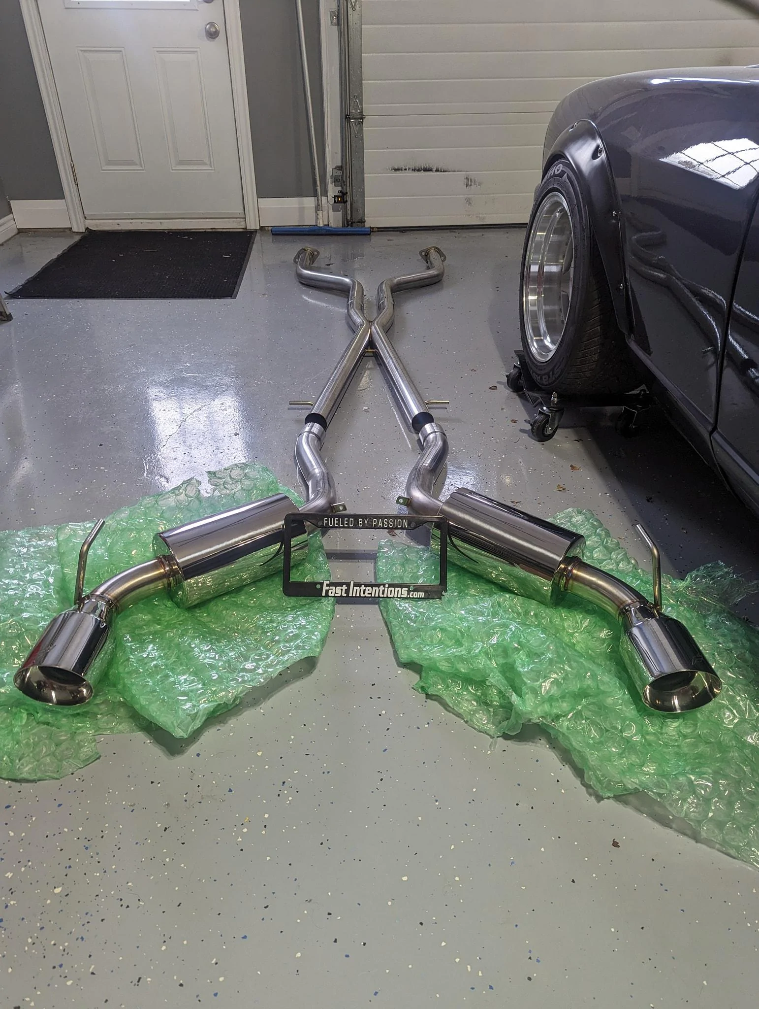

Anyone have any tips for installing the Fast Intentions exhaust? Mine is getting installed this afternoon and I want to be prepared since I’m “borrowing” the lift at a local garage.

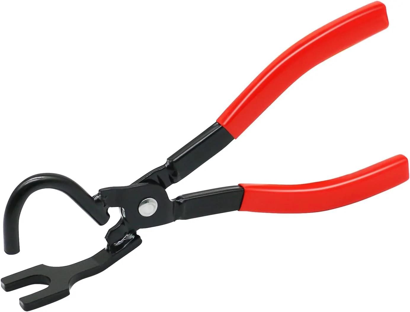

6. Use an Exhaust Hanger Removal Tool if you have one available. Useful for both getting the old exhaust off and the new one on. Looks like this:

I got the non resonated version. Still waiting on a car to put it on hahah. As soon as I install, I'll try and remember to make some before and afters. Not a whole lot of exhaust vids going around yet.

Yep, the pipes are joined up in the middle there to as an X pipe of sorts
