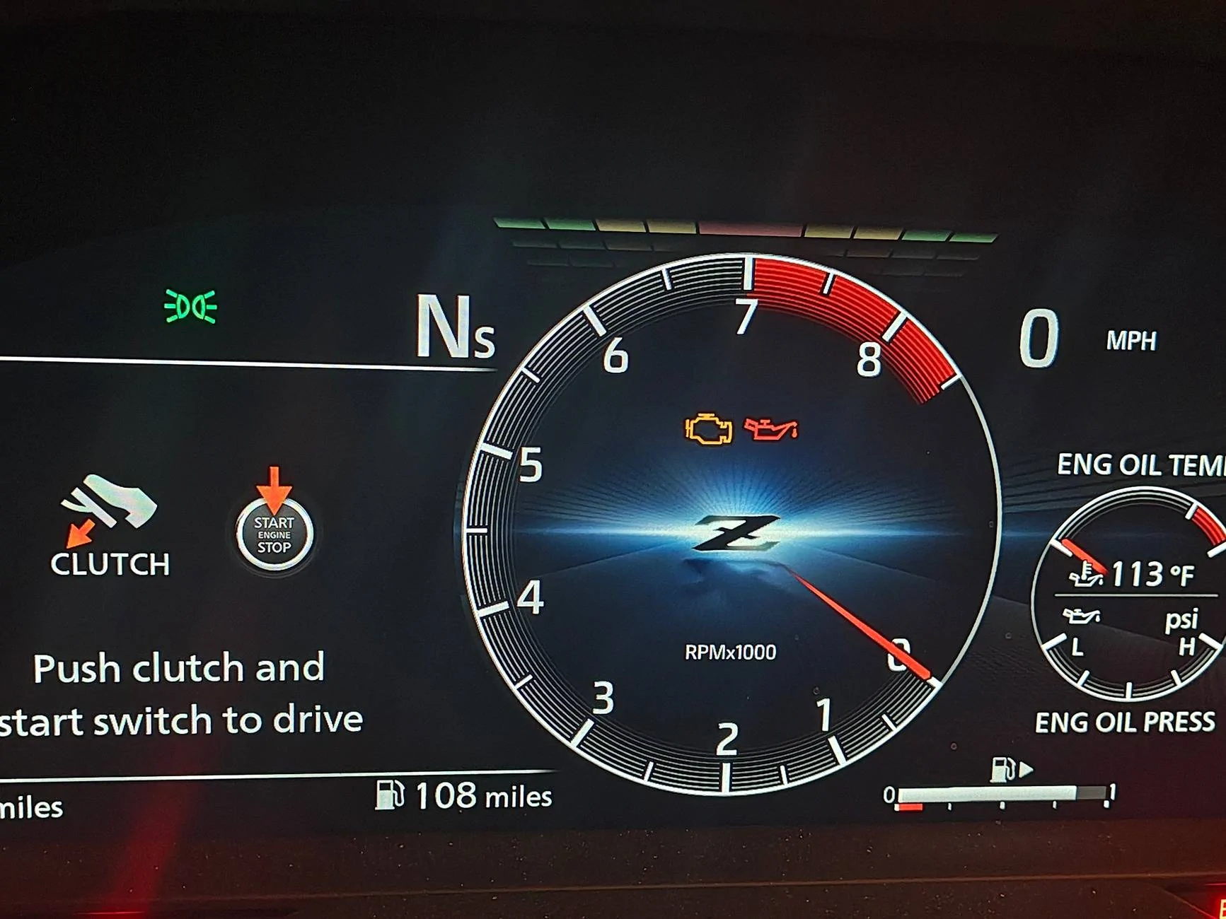

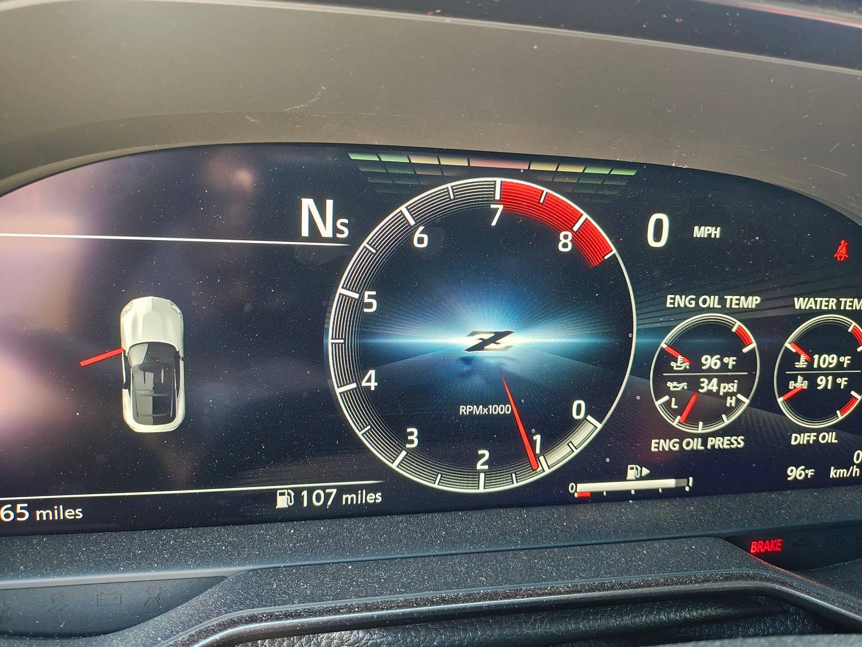

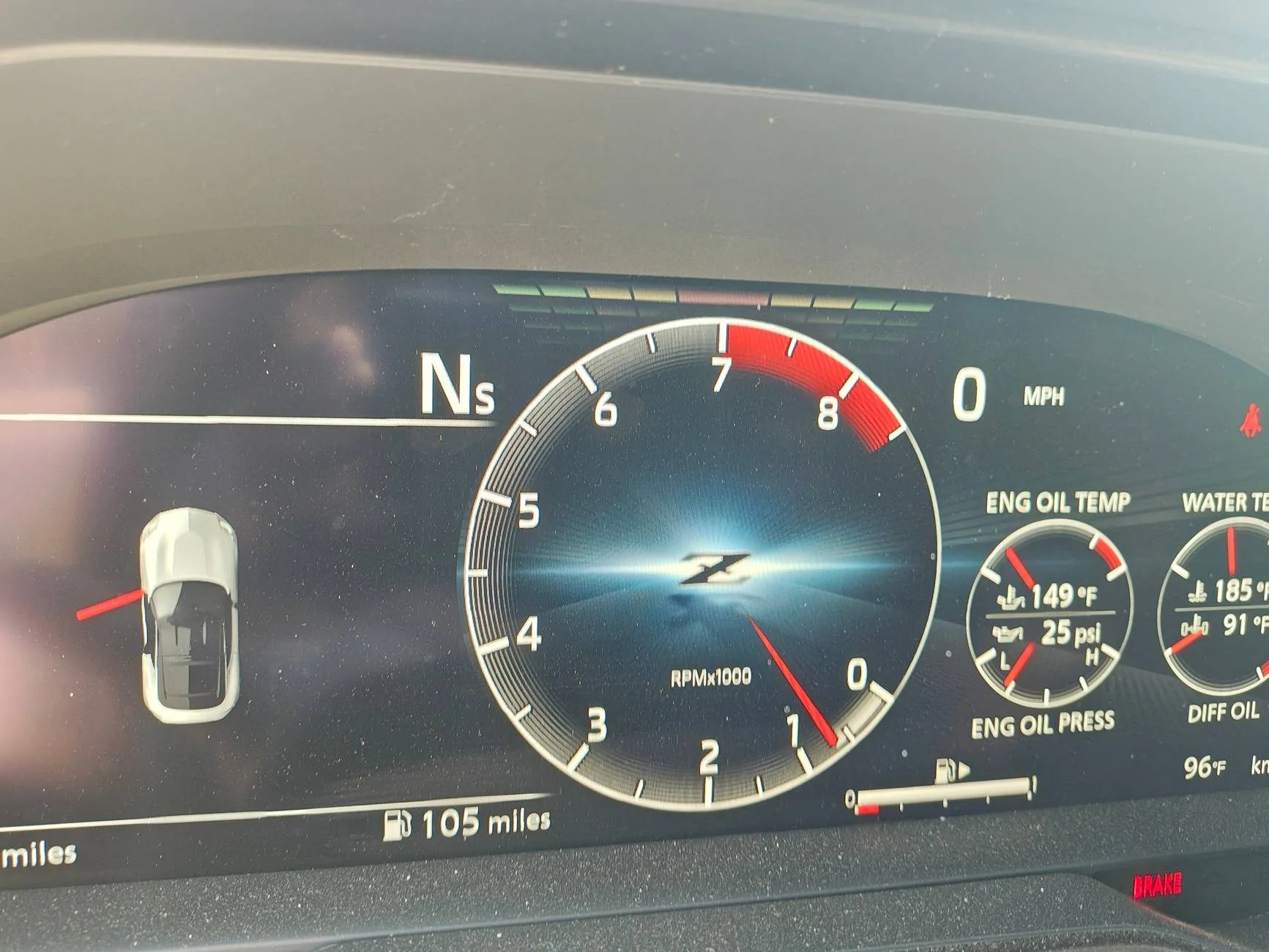

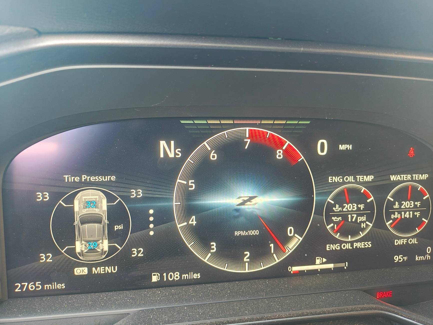

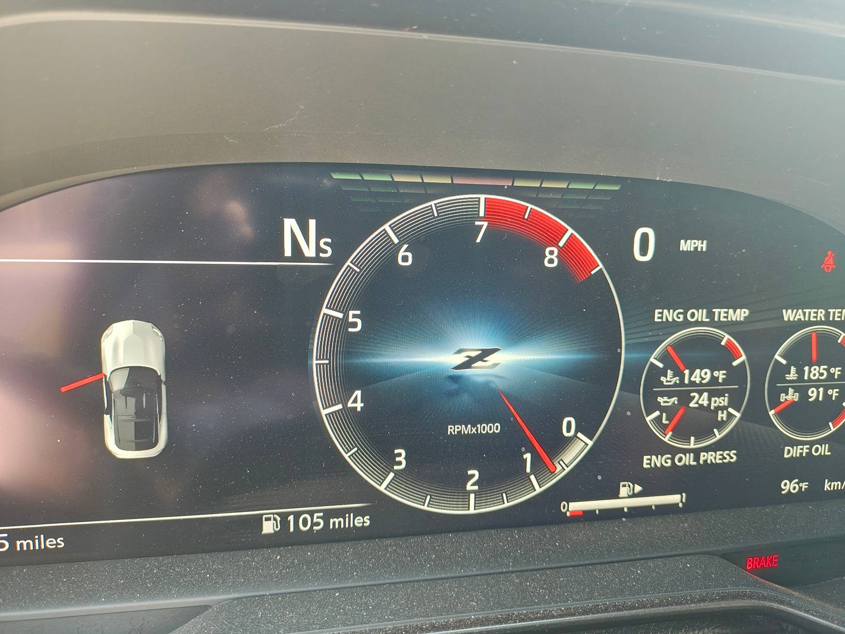

I stopped and filled up my gas tank at Exxon, pumped 91 about $45 when the pump clicked and stopped. As I drive to the 1st stop light I still show only 114 miles (left to empty) and the bar is only half full. I killed the engine and started it to the same display. Did the same thing again after I got home, and again this morning. The bar is filling but "miles till empty" keeps going down not up.... Let me know if anyone has seen this B4? 2024' manual Z car by the way

I'm spaz if they tell me this is normal or say fill up only at 1/4 tank (I did by the way) the car cuts power after half at tank

I didn't get a "real" answer but I'll share the explanation: New 24 purchased in Feb. 2800miles, still STOCK. "The battery terminals must have wiggled loose causing the computer system to go haywire" they disconnected the battery (resetting the computer) and said it's all good now. I don't have a real cause but I got a solution. Still might happen again
