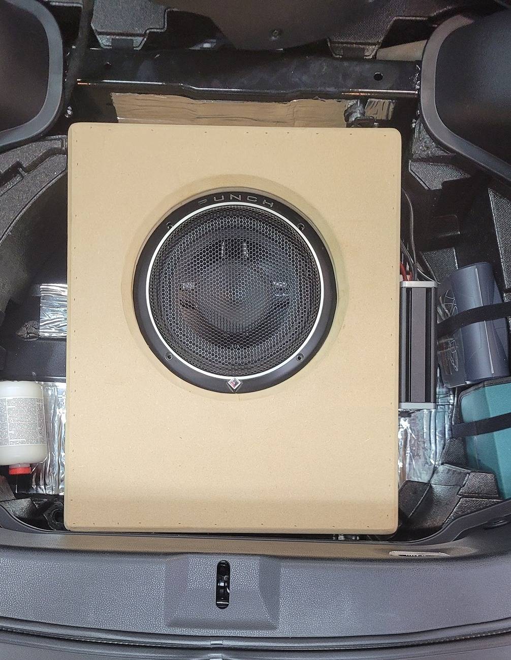

I went ahead and order the harness, and while waiting for it I started building my sub enclosure.

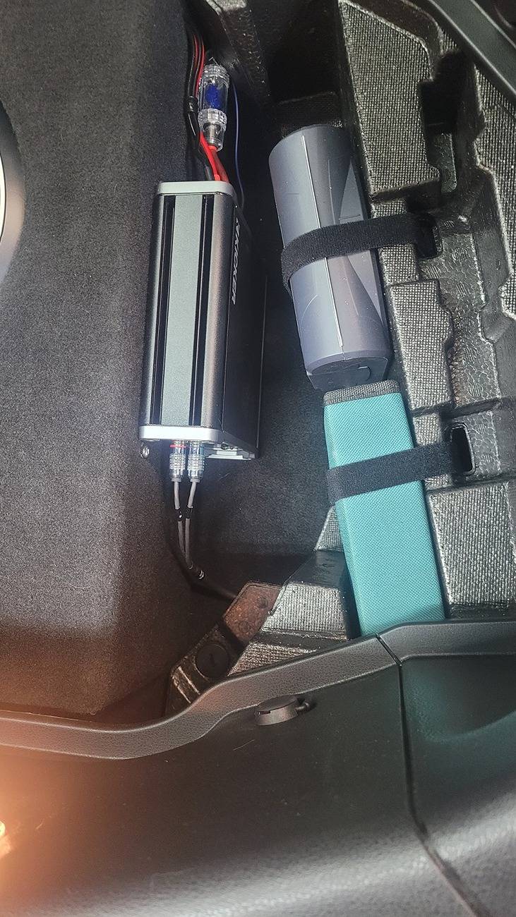

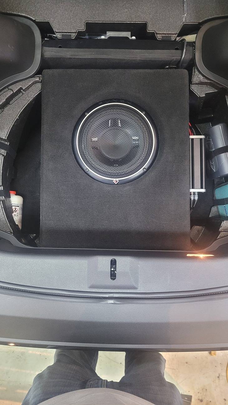

Been busy last few weeks. I did finally receive the harness and got everything installed. Overall, it was a decent harness with everything labeled. The instructions were lacking a bit, as it only gave very general instructions. The biggest pain was just accessing the Bose amp. I ended up cutting the foam that sits on top of the amp to avoid removing all of the trim panels. It was pretty straight forward like its name just plug in inline at the amp. Then run wires to the new amp. They include a connector that can be left unconnected to bypass ANC, which is what I did. It was a little bit more than I wanted to pay, but worth it to not splice into factory wiring. Plus, easy to remove if I ever want to sell the car. I had previously run a power wire from battery compartment through the grommet behind the battery. That part was a little tedious, but not as bad as some cars I have worked on before. Sorry I did not get any pictures of the process, just after installation was complete.
