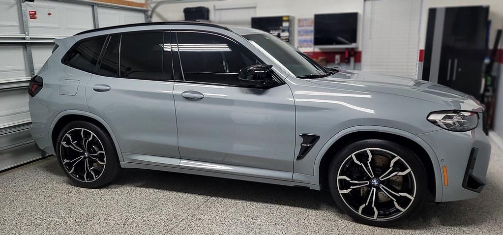

BEST prosumer Ceramic Coating that I have used and highly recommend is Gtechniq CSL + EVO. This is by far the best ceramic coating (assuming you are going to take care of the coating during each wash by using a spray sealant "topper").
If not, then you can do Gyeon Cancoat (~3-6month coating) and follow up with spray sealant post wash to extend life to 6months.
And if you dont want to do even do that, then use Phoenix Glossome Wax, Collinite or Jescar Powerlock & Color lock plus.
Use any of these AFTER IronX & Claybar paint at the bare minimum.
Best case is Gtechniq (do some polishing beforehand), Gyeon Cancoat (Claybar & IronX), Glossome/Collinite/Jescar (IronX) after wash.
This is after Jescar Powerlock/Colorlock and then topped with a Spray Sealant blend for the shine.
