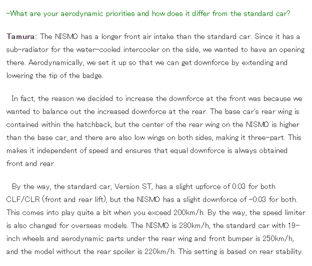

That's weird as Nissan says 173 for the nismo vs 155 for the performance
Its definitely 155, its a soft limiter that cuts power at exactly 155 and reengages at 150. I would be ok wit 173 but the car is still pulling hard at 155. Sooo annoying.
148
2,787
4,810
thats interesting so only thing I can think of is the quote of 173 came from Tamura-San so maybe he meant that is what its a capable of and didnt realize the US market puts a restriction on it. in Japan they are all limited to like 118 or something like that. NISMO Japan actually makes an ECU for our cars that removes the limiter. its called NISMO sports resetting package

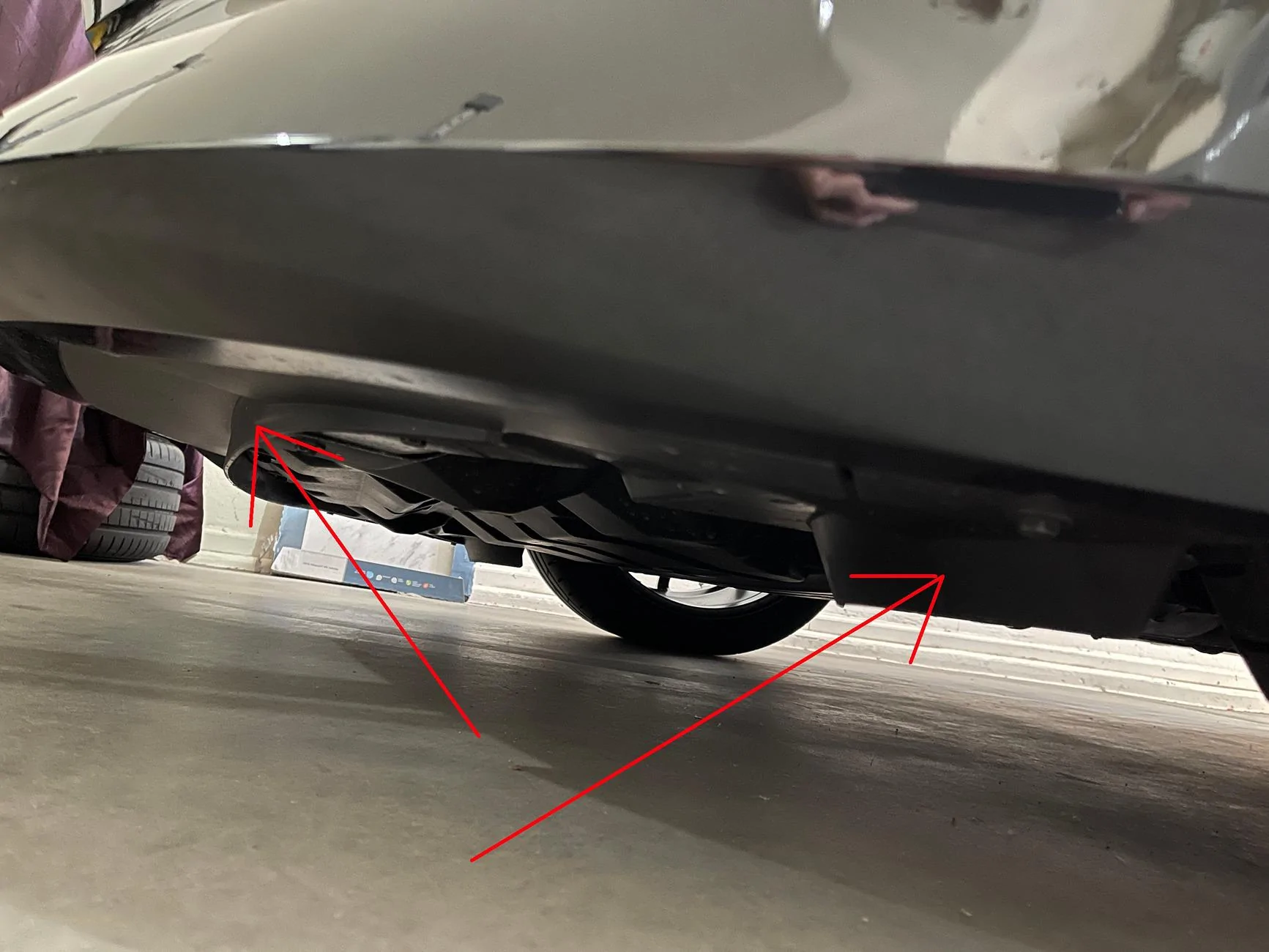

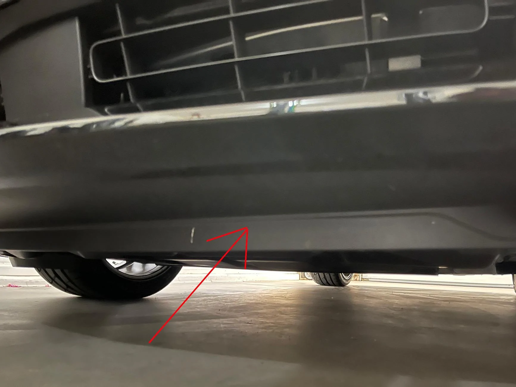

its the lack of rear spoiler and front under spoiler.
most people dont know this but eve the performance Z with the spoilers generates a tiny amount of lift at speeds over like 120ish
There is a front under spoiler for the Sport model. I will get a picture and post it in a few minutes. When I look underneath the front of the Sport, there is a spoiler hanging down about 2 inches thick.
I got a chance to look underneath the front of the Z and it looks like there are 3 spoilers underneath the front. There is the main front underneath spoiler and 2 smaller spoilers for the LEFT and RIGHT side underneath the Z Sport.
I am not sure if the Performance and Nismo got the 3 spoilers underneath as well???
