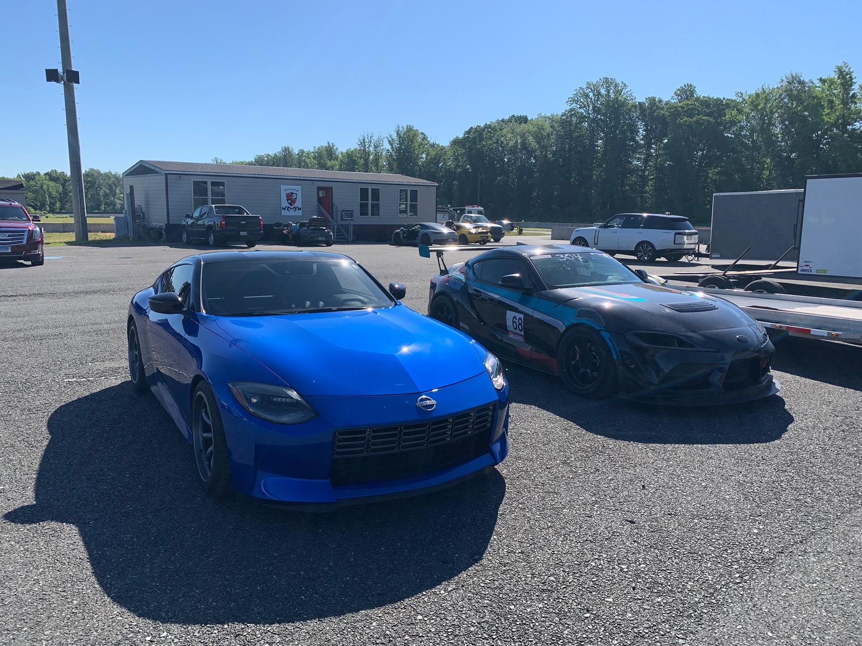

drove this one on track for 20 mins and instructed the owner. He was a “enthusiastic street driver” w 20 years of experience. I scared him when I showed him what real track driving was and demonstrating the limits of his car.
I race, instruct, and ave 35-40 track days a year.
I am a fan of the Z for what it is. A sporty 2-door while the world is shunning sports cars.
it is NOT a good track car off the showroom floor. It needs suspension, brakes, fluid, cooling and a diet. I don’t think several of the components (like differential ) will hold up to more than casual tracking or auto x. It Is floaty, it does understeer and the lap times reported by professional track reviews reflect this.
it has potential, but someone will have to commit to spending real $$ on their car and I have not seen any on tracks in the mid Atlantic.
they are beautiful, have decent power and great JDM heritage. Street driving does not come close to track driving. As an instructor I have to unlearn a ton of “street driving” from newbies.
Honestly, I want to encourage bringing your Z to the track. Get a good instructor. And I am serious- upgrade your pads and fluid in these. They failed on my student 3/4 through the day.
