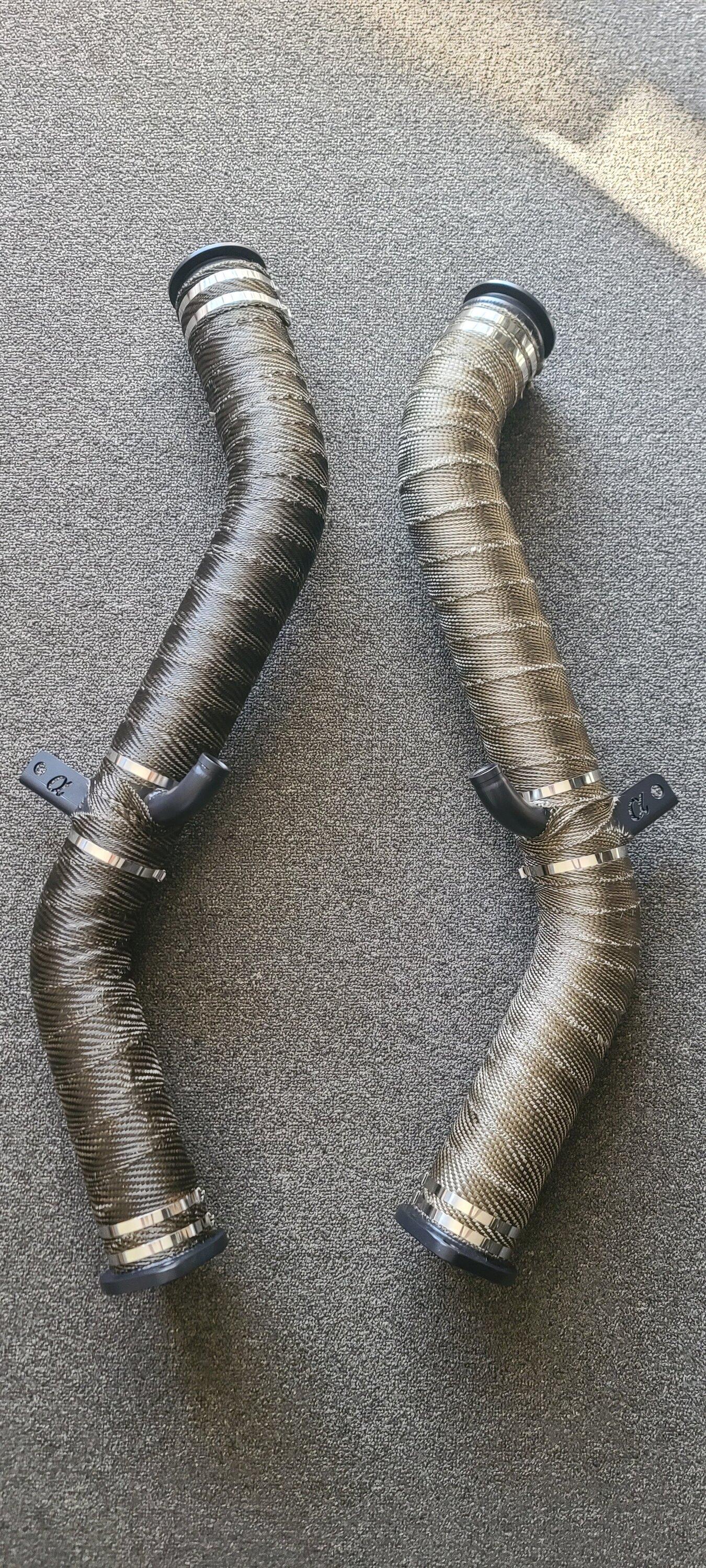

This Weekend I got my AMS Performance VR30DDTT Race Full Downpipes and Boost Logic Formula Series Titanium Exhaust installed. Also have AMS Intakes installed prior to this
I had my DPs & Exhaust ceramic coated locally at RaceCoatings. DPs were coated Matte Black and wrapped with DEI Titanium to hold up more heat, while the exhaust was polished ceramic. Left the tips Titanium.
Here they are installed, i just realized my left exhaust is aiming hard left, so ill be fixing that shortly

Now, i'm going to have to say, im not really a big fan of the Catless Downpipes, im now looking to get the Catted version. Reason is, this set up is OBNOXIOUSLY LOUD. I don't intend to be a heatscore and get my car defected from casual driving. Plus the droning is INSANE. To top it off kinda reminds me of the 350/370Z trumpet exhaust. Which is kind of a turn off for me.
SO will be looking to getting it tuned in the meanwhile, then slap the cats on after

While it is so hard to make a judgement call on volume levels from videos, I can (on the take off video) hear the rasp that hits at a specific rpm. Besides that, the sound and tone are pretty sweet! Hopefully adding the catted DP’s fix it for you. Most definitely thanks for sharing!! Going the extra mile with the ceramic on an already premium exhaust, I’m a fan. Looks sick!

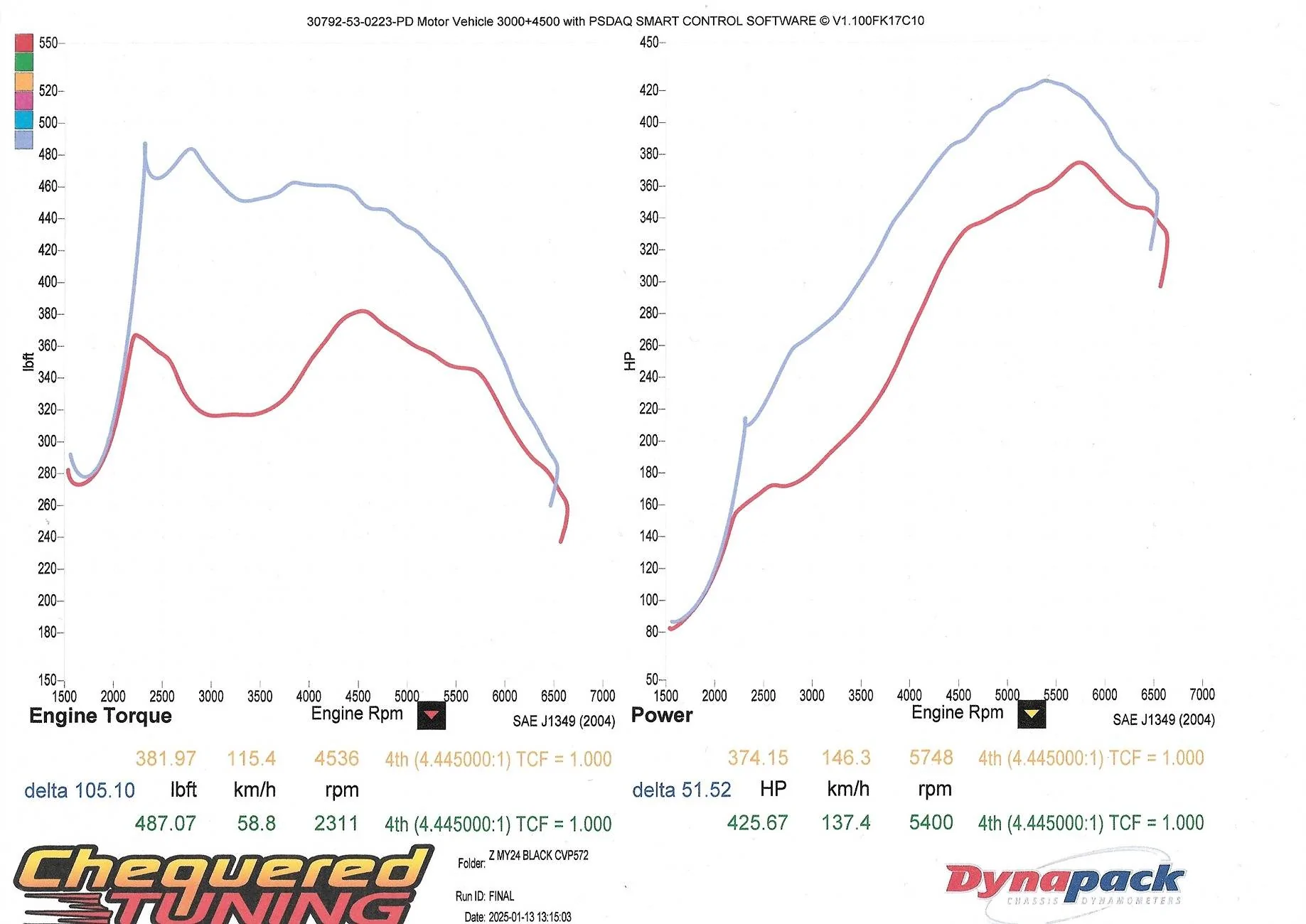

Alright! Now the dyno results are in,
Red is OEM: No Mods
Blue is Me: Modded
Mods to include,
Cooling: Z1 Intercooler Coolant Pump Upgrade Kit, AMS Performance Heat Exchanger, Intercoolers & CZP Silicone Turbo and Throttle Body Coolant Hose Kit
Intake and Exhaust: AMS Performance CAIs & Catted Street Full DPs, Boostlogic Ti Formula Exhaust
Other: GKTech Polyurethane gearbox mount & Rear subframe slip-in collars (not sure if this would have made a difference in the power delivery to the wheels), & TurboSmart Kompact EM BOV VR25 Dual Port Suit
Fuel: 98 unleaded octane from BP
I'm actually suprised that from factory the Z only comes with about 370whp. With the mods without the tune, we got it clocked in at 394whp, baseline tune @417whp, and final tune at 425whp
Driving it,....... HOLY F***, gonna have to get used to it again, but she rips hahaha
