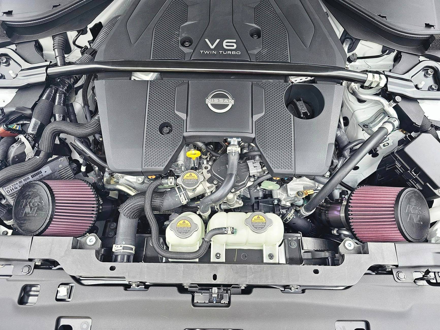

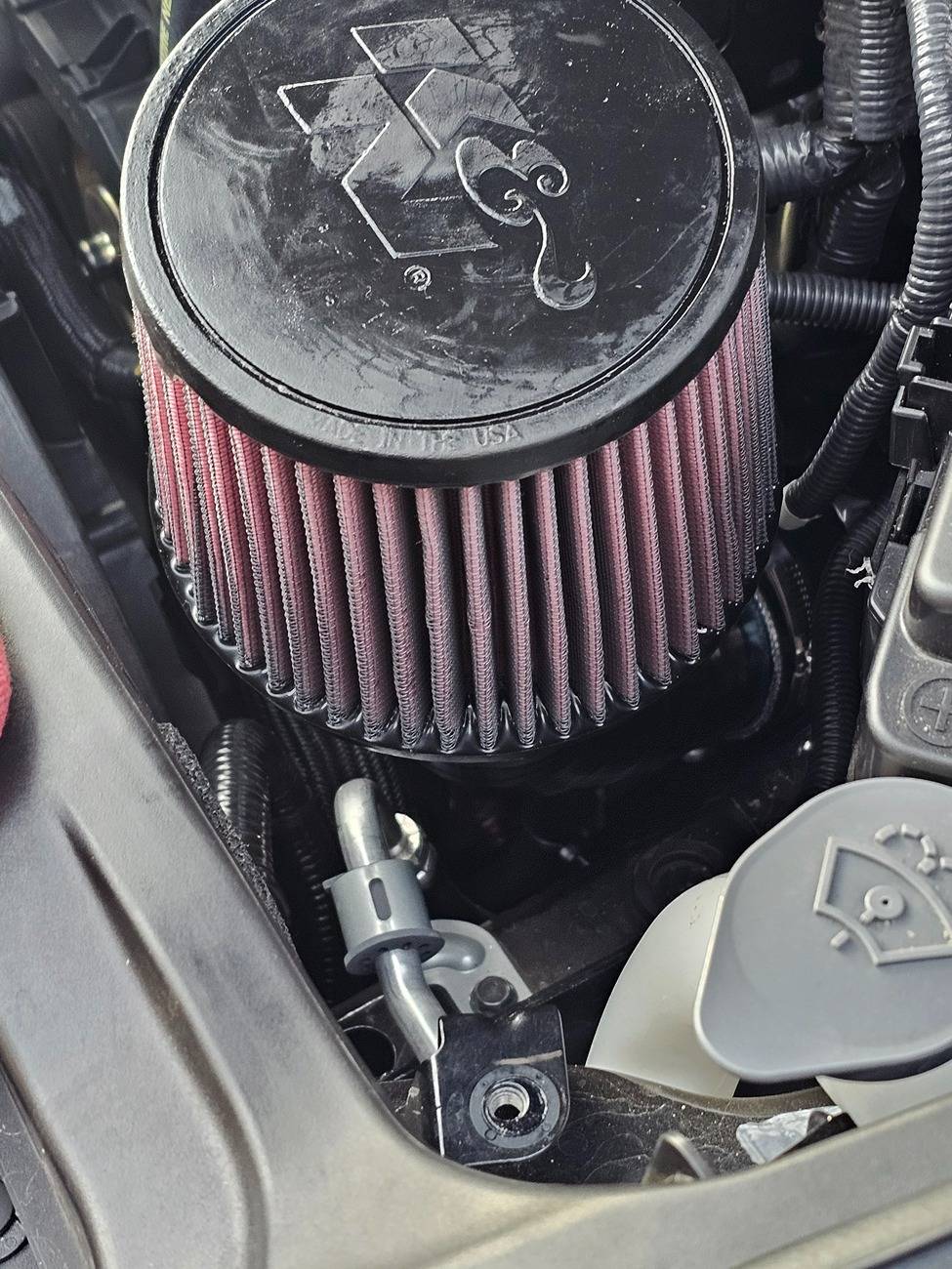

Yeah it could possibly help keep the filter cleaner, but mostly to seal the top from hot air when the hood is closed. On turbo cars the filters get dirty quicker regardless. Also the access to remove the filters is very easy on this intake.
How difficult was the install? The instructions look pretty straight-forward.

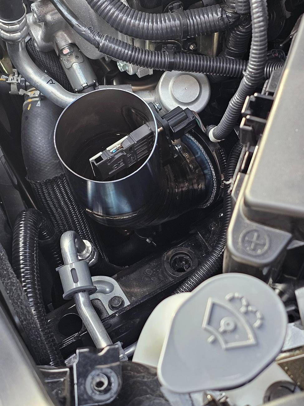

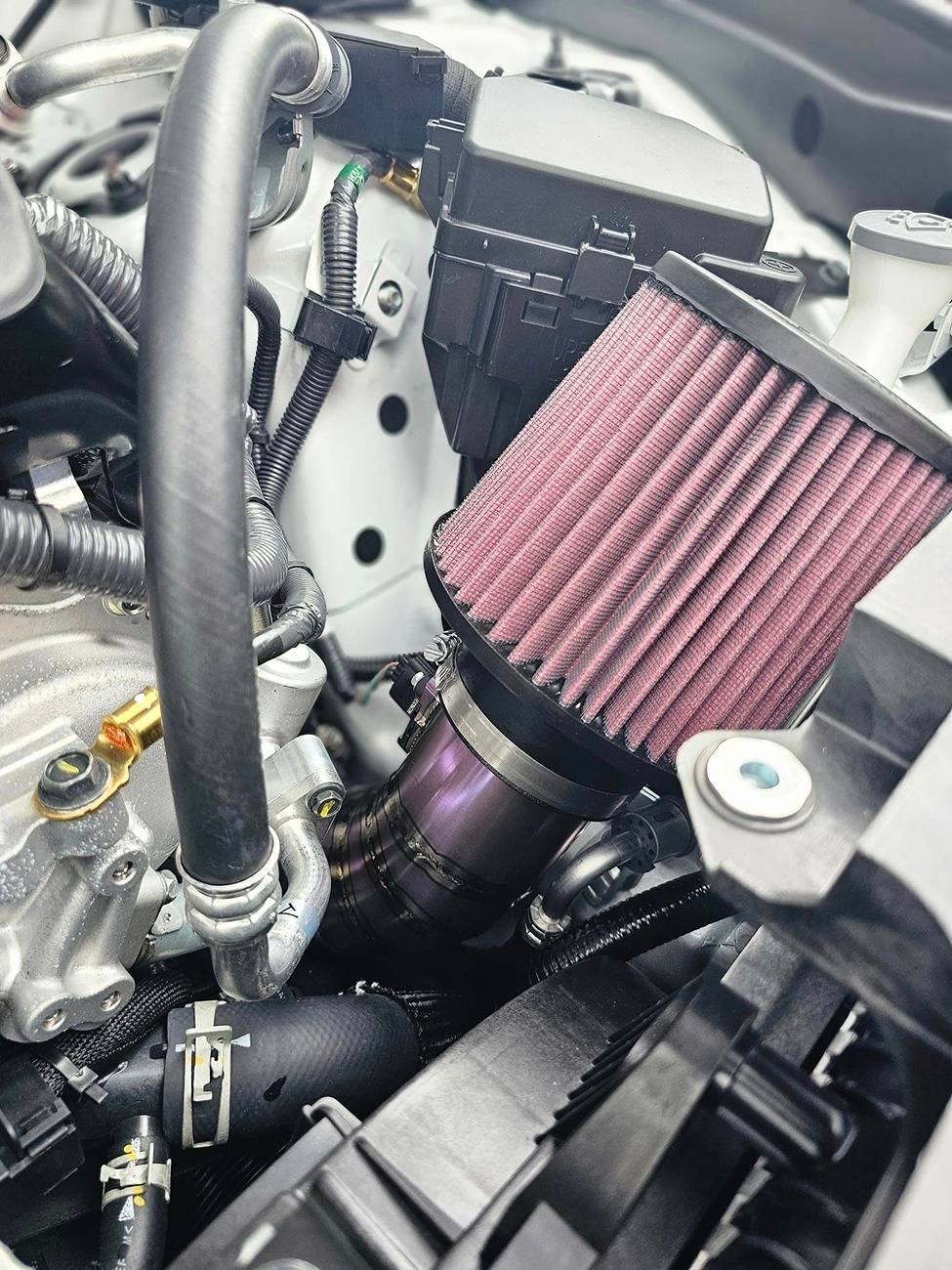

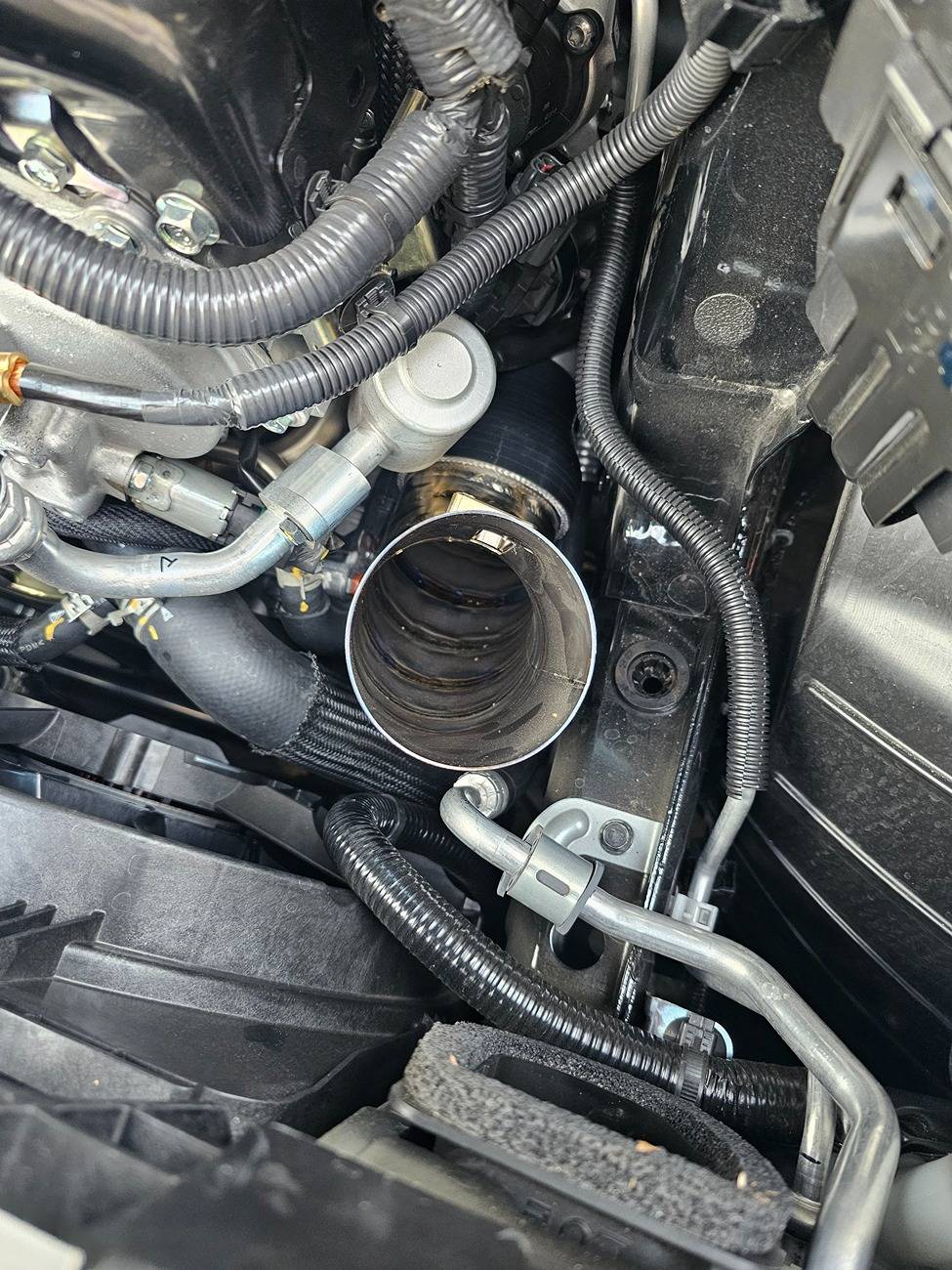

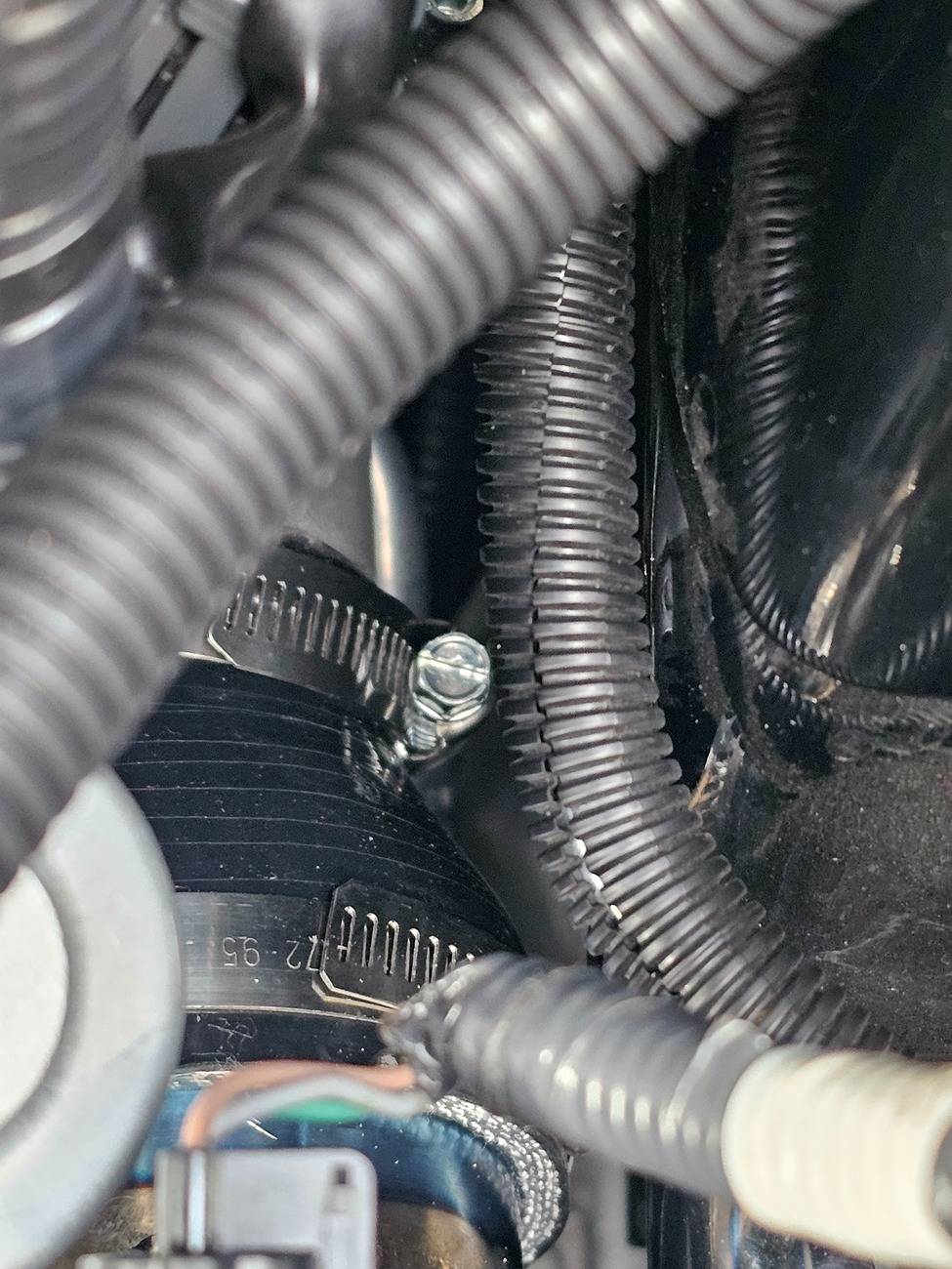

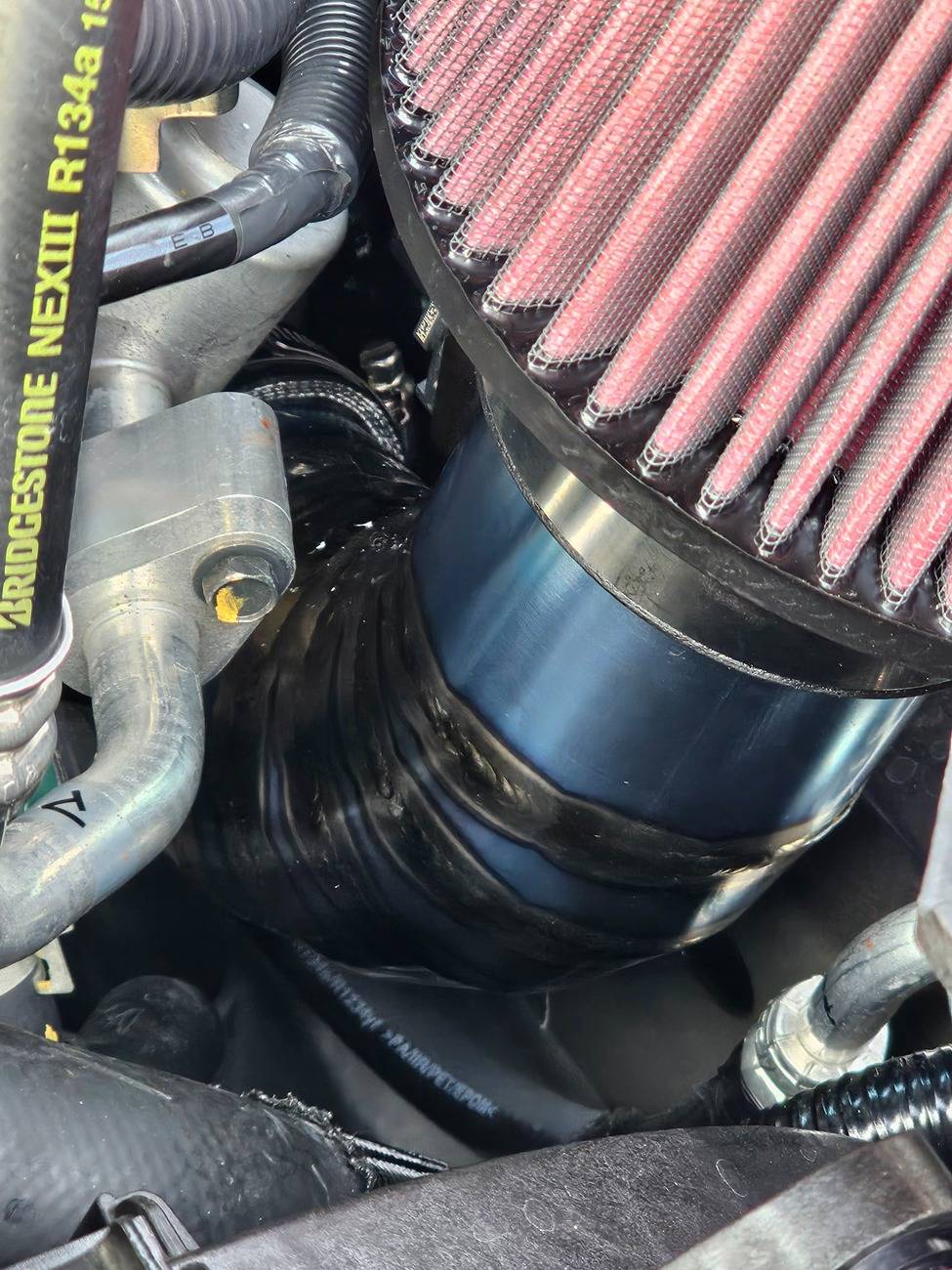

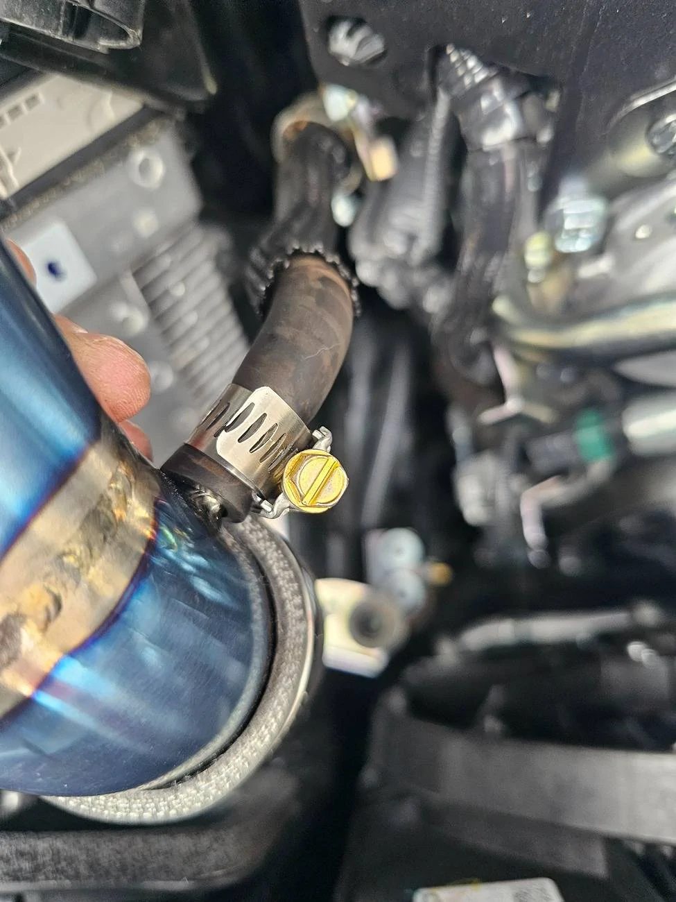

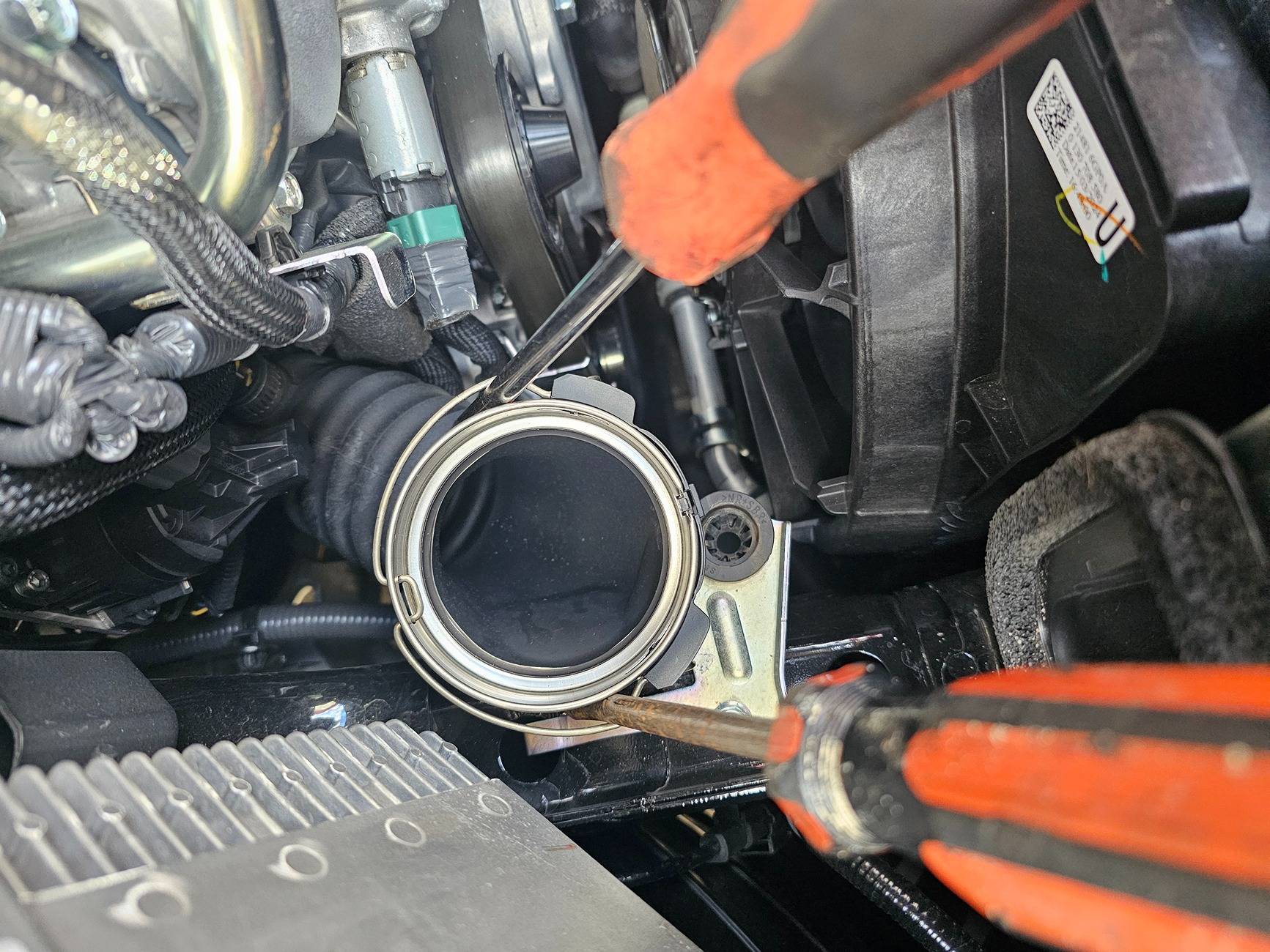

I think the hardest part is to remove the OEM intake. I already had a Nismo intake so it came off in 15 minutes. When installing the K&N make sure the passenger side turbo inlet boot is seated ALL the way on, its a tight fit so its hard to get it fully seated. After that its all gravy. I spent a few extra minutes to make it look as symmetrical as possible to satisfy my ocd..

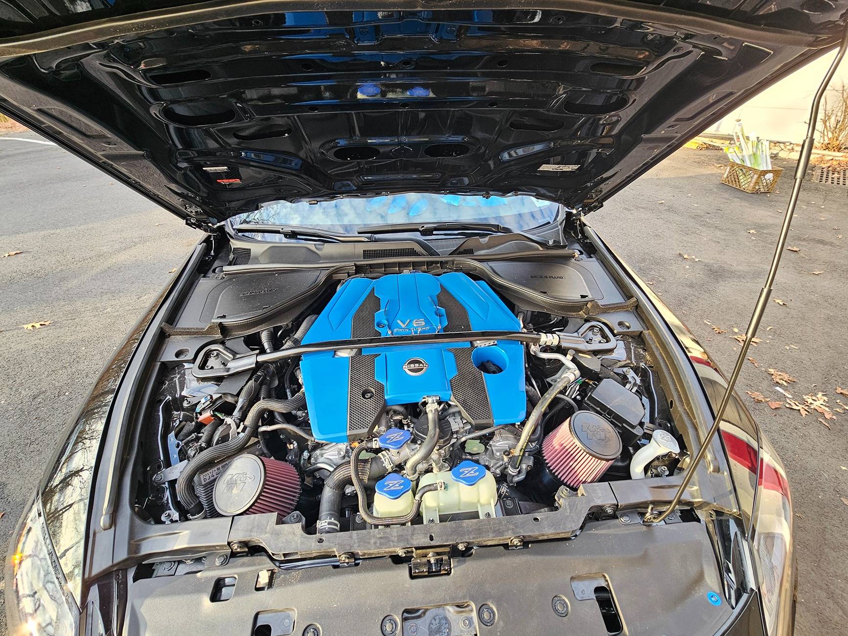

I have the nismo CAI and kept them covered because I don't want warm air from the engine bay going back in. I can still hear the air induction when punching it. The CAI improved pickup from a stand-still position and even in the lower rpm range.
Heat saok is not relevant on turbos - that air goes through the turbo then to inter coolers and heat exchangers. So don't worry - run them open - just FYI
