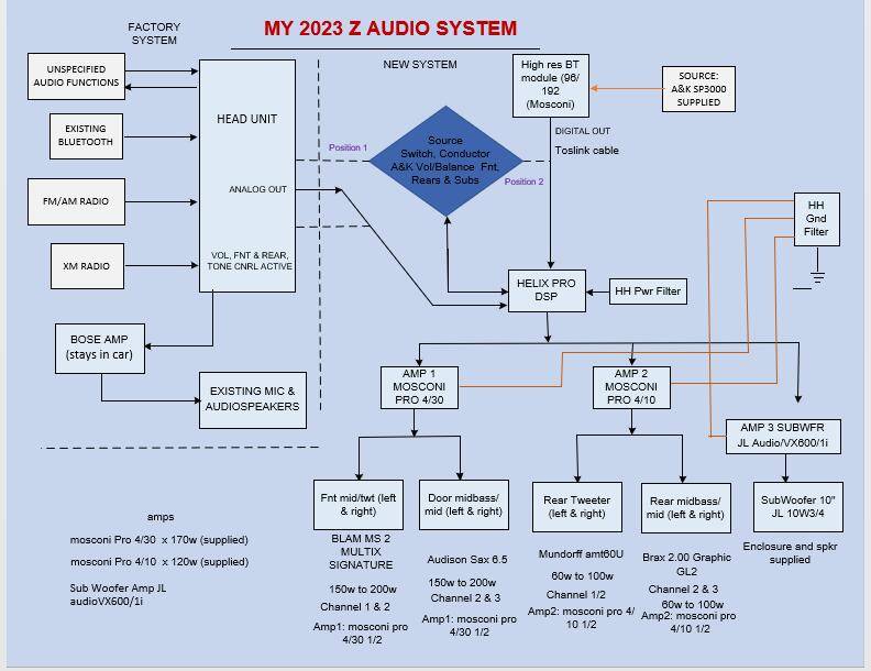

The system has two modes of operation,
  • the Bose HD unit, AM/FM and the XM radio
  • the High resolution Bluetooth Mode wireless connection to the DAP A & K 3100.
System is controlled by a dedicated rotary digital switch (Helix Controller) which toggles between the Bose HD unit and the DAP A & K 3100. The mounting for the switch is to be determined during installation. It may end up being in the on center console or cup holder or on the roof near the interior light switches. Volume control will be adjusted thru the rotary digital switch (Helix Controller) for the A&K 3100 unit and the Bose HD unit will use the steering wheel and front panel controls. The custom DSP presets are for the AMPs are also accessible using the rotary digital switch.
The Mosconi High resolution Bluetooth Module will be connected to the Helix Digital Signal Processor with a digital cable that will reject a very large portion of EMI energy within and outside of the car. This will maintain a higher degree of signal integrity then running a ā€œanalog cableā€.
The Helix Pro Digital Signal Processor will connect to these three amps.
  • Mosconi 4/30 (door and dash speakers)
  • Mosconi 4/10 (rear panel mount)
  • JL Audio VX600/1i
Power and Ground filers:
Harmonic Harmony EHD Filters:
  • EHD Filters Source for Power input to Helix DSP
  • EHD Filters EHD Master Ground for amp chassis.
The Speakers are:
  • Door Speakers: Audison Thesis 6.5ā€ (mid bass/midrange)
  • Dash Speakers: Blam MS 2ā€ Signature MULTIX (mid tweeter)
  • Rear Panel Speakers: Brax Graphic GL2 50mm (mid tweeter)
  • Rear Tweeter Speakers: AMTU60W1.1-C Air Motion Tweeter
  • Custom Mounting enclosure
  • Subwoofer: JL Audio JL10w3 4 ohm – Zenclosures Z sub-box
Speaker cables: Mundorf Copper Angelique Copper Silver/Gold conductors 13awg
Interconnects: TBD

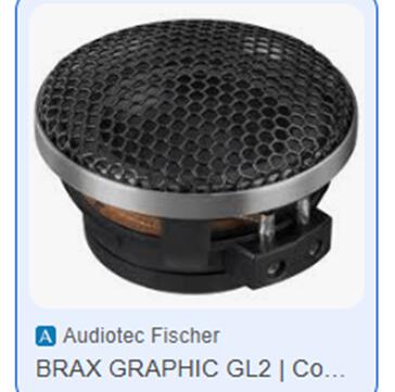

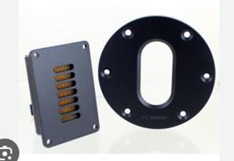

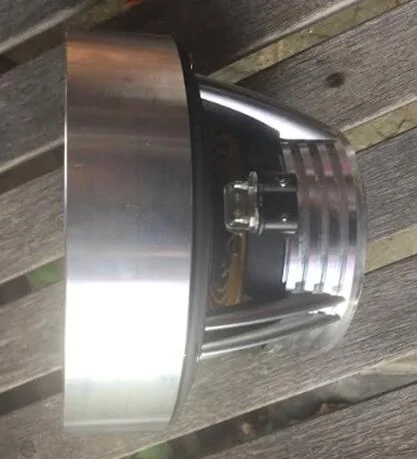

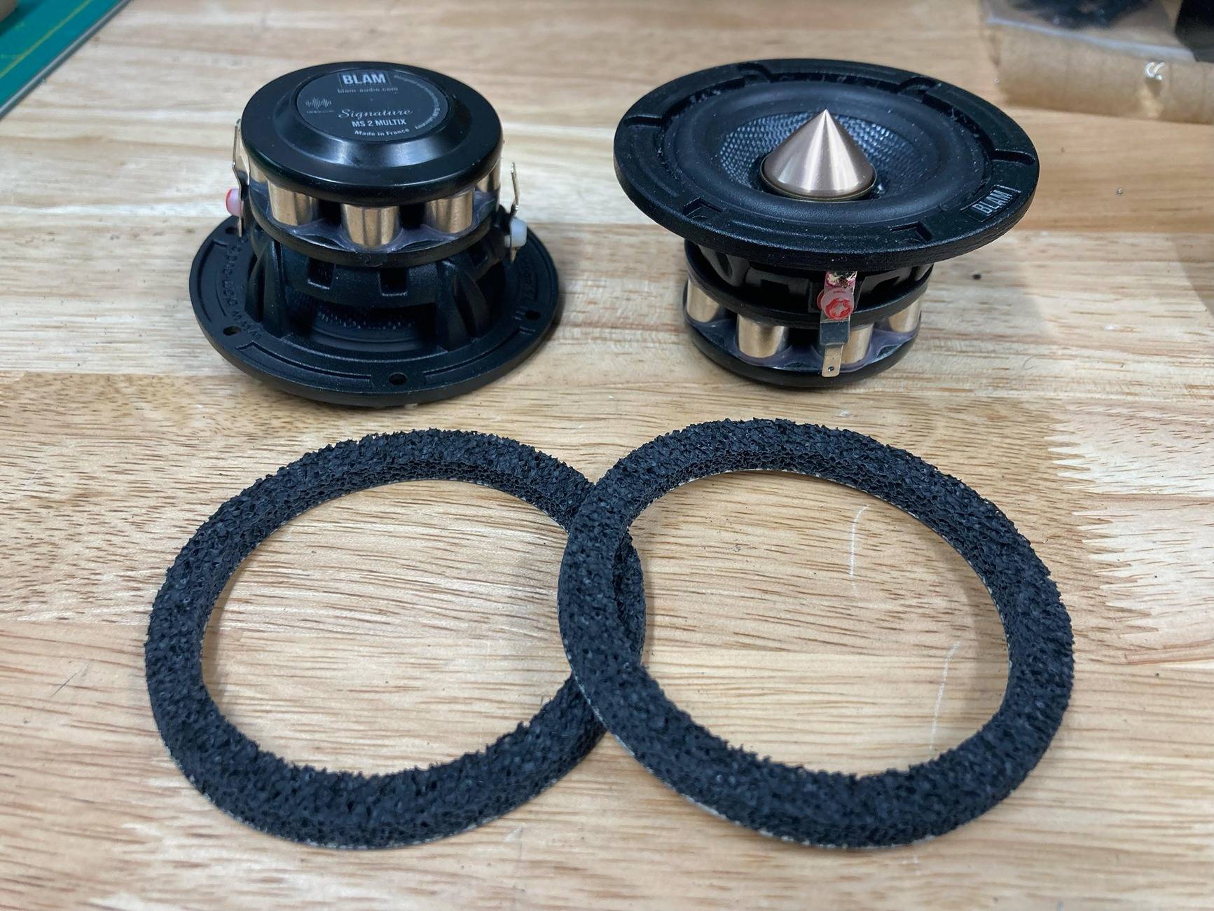

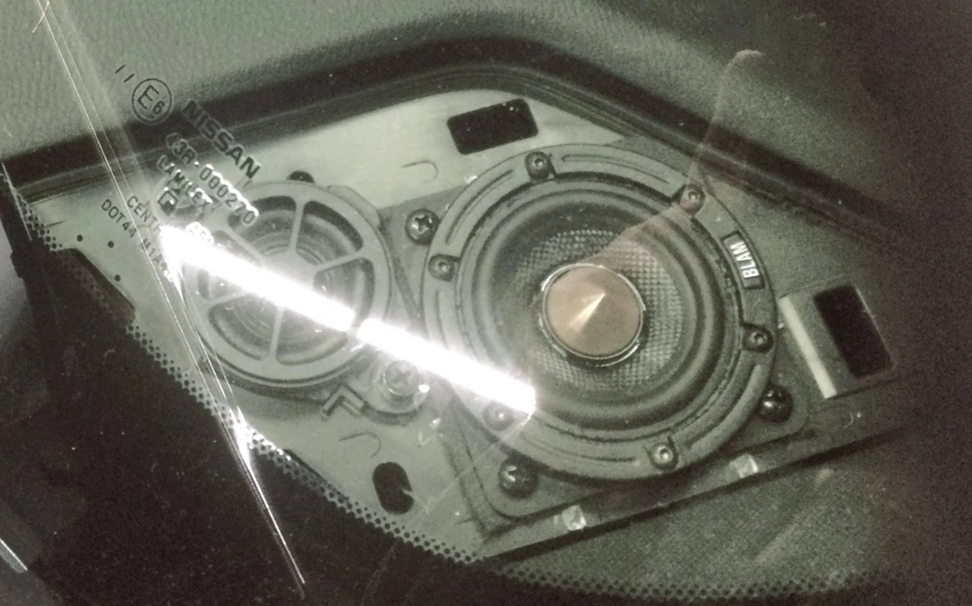

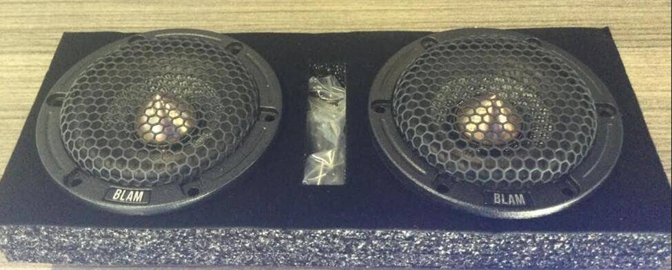

Here are pics of the speakers
Dash 2.5 Speakers Blam
Door Speakers: Audison 6.5 Sax

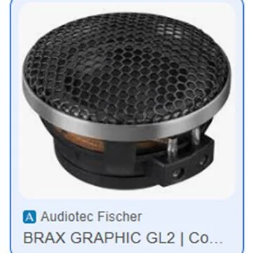

Rear Speaker 2.00 inch
Rear Ribbon tweeters

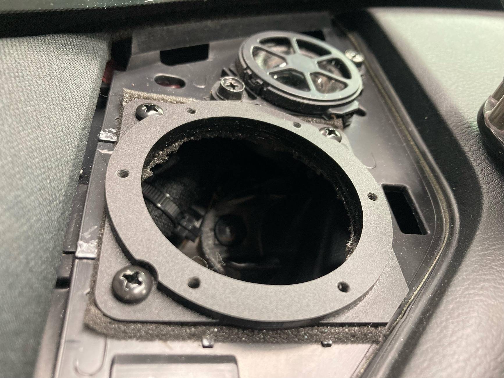

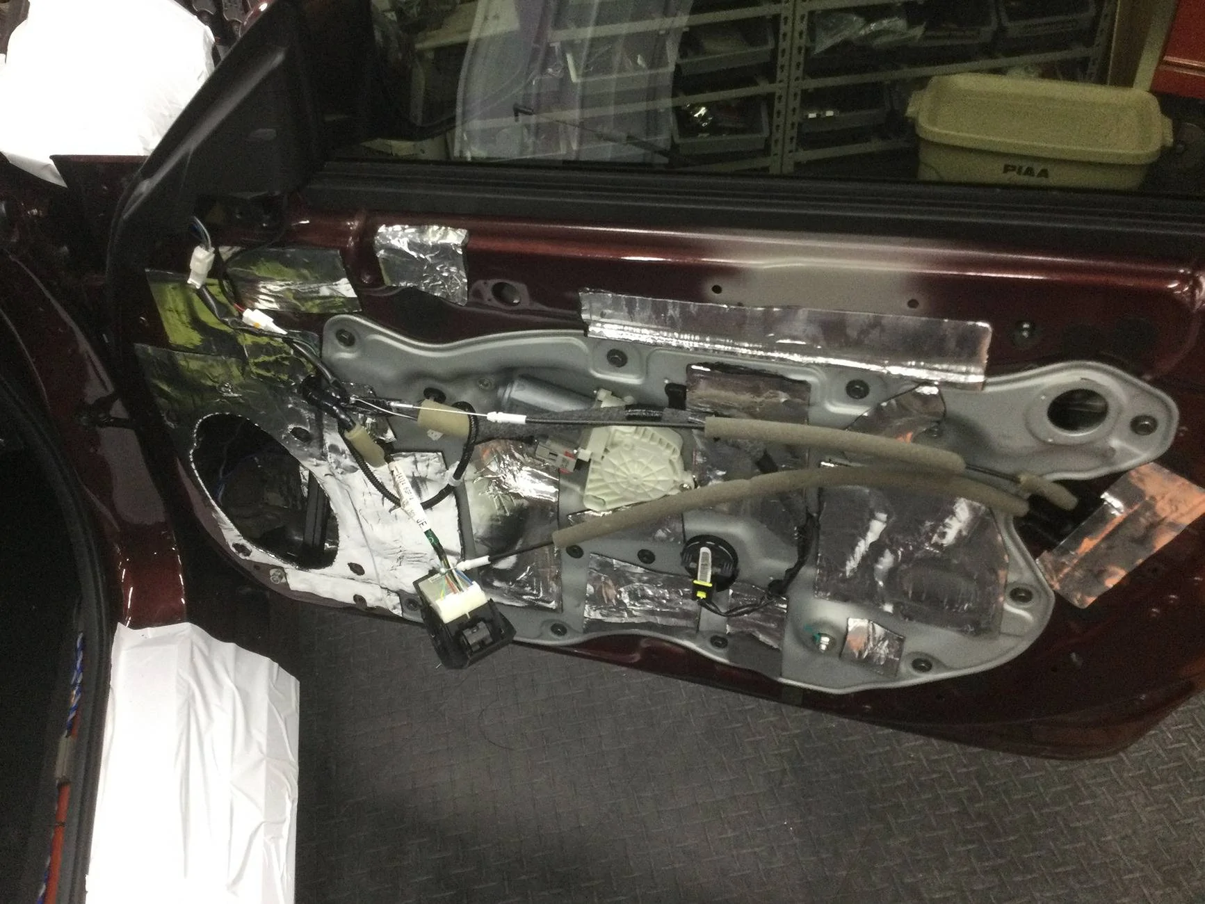

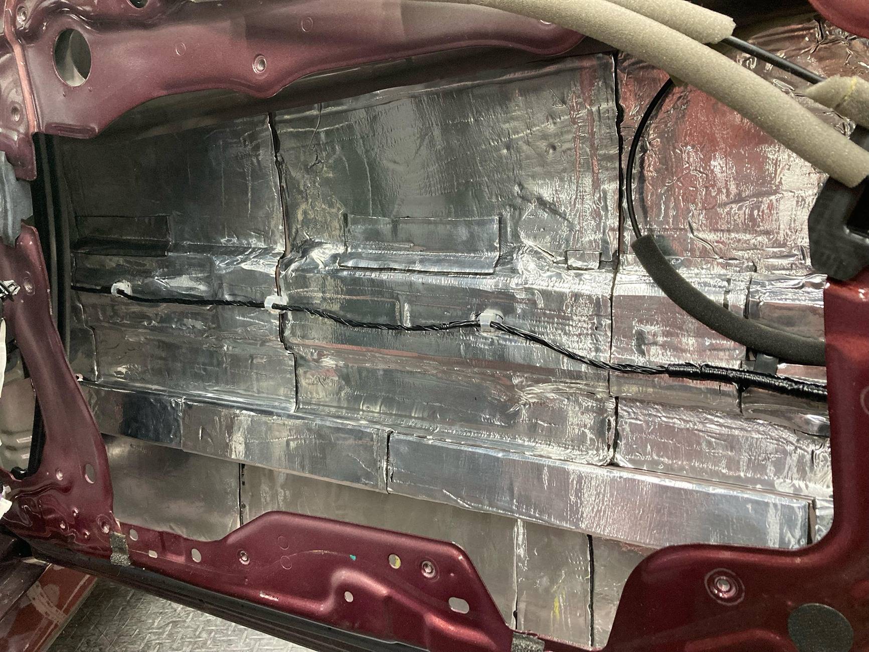

I will upload some pics this weekend. I am stopping by the shop on Sat. Overall, progress is good. Its a 2 week labor effort! This week was sound damping, making spkr brackets and install the speakers. New week, Amp/DSP platform and turning!
