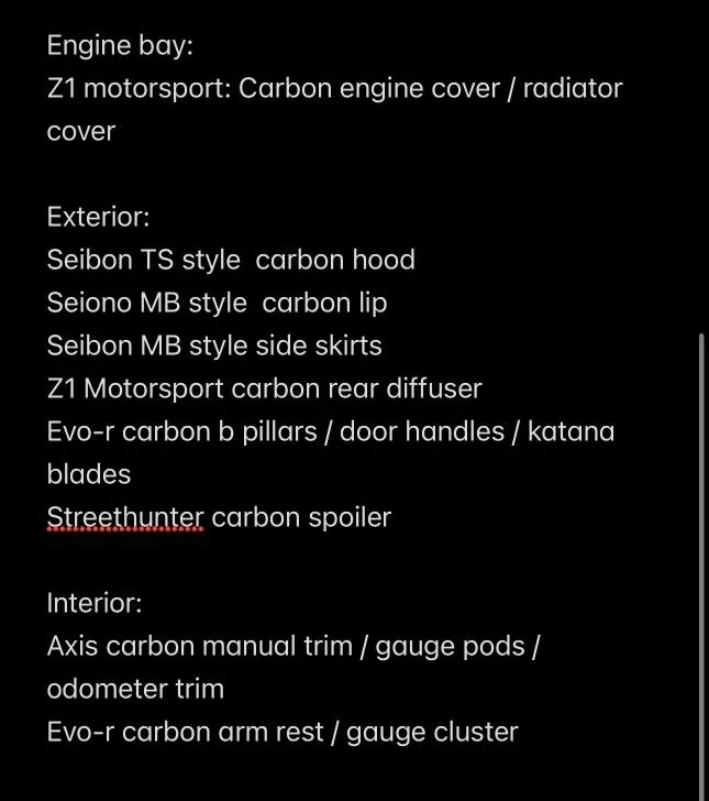

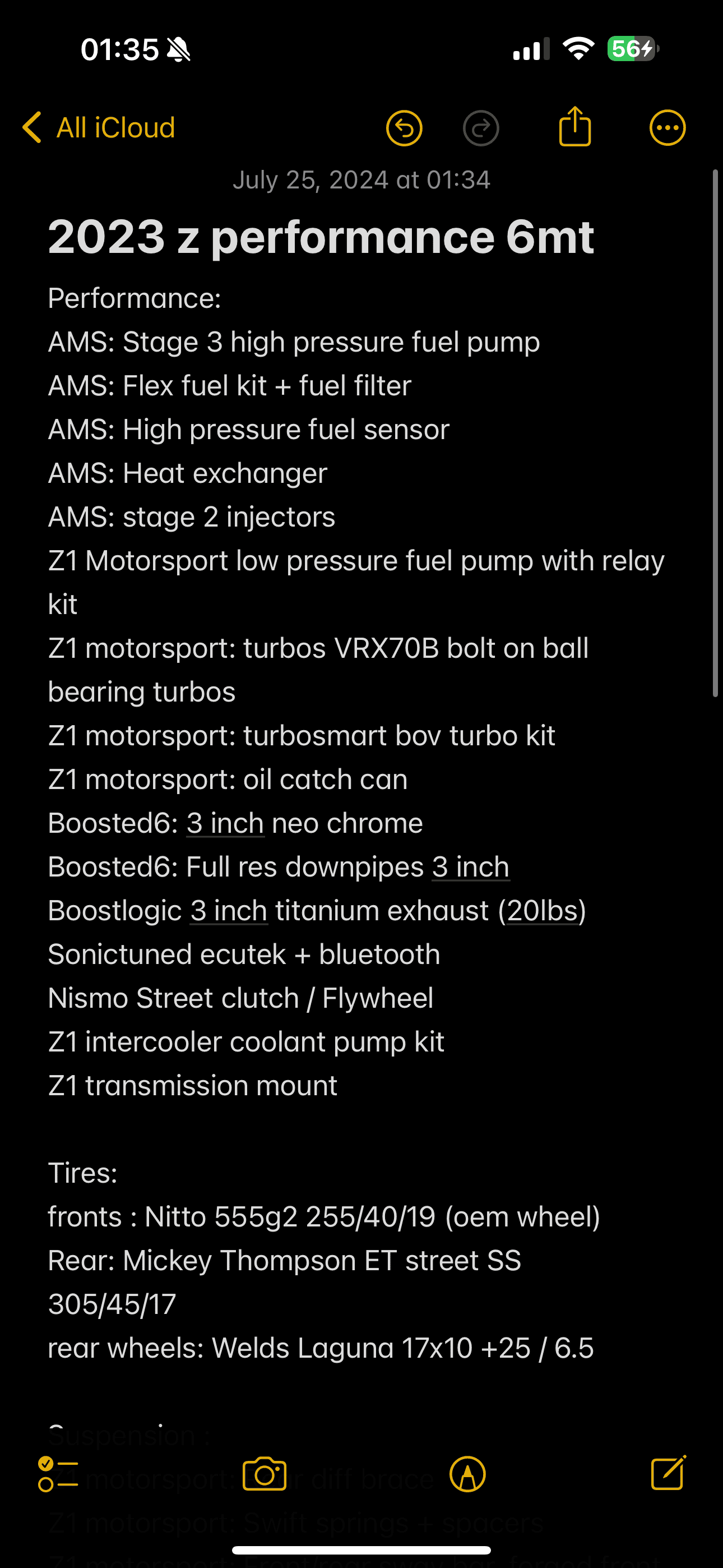

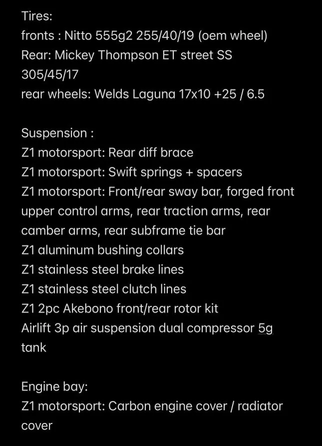

for people wondering, car price and full parts this build is under 80k total, got discounted on majority of the parts but still hurts the wallet .. LOLLLL
705 whp at 24lb boost spicy e60 mix
turbos max out at 30lb, we kept it at 24lbs
upgraded z1 vrx70bb turbos + full e85 + supporting mods
MT et street ss drag pack rear, 17 inch 305's with custom powder coat welds ( full info in build pics below)
I don't gate keep anything with the fam.
full build in pics below + mini video clip of the turbos, mid boost, car pulls insane.
