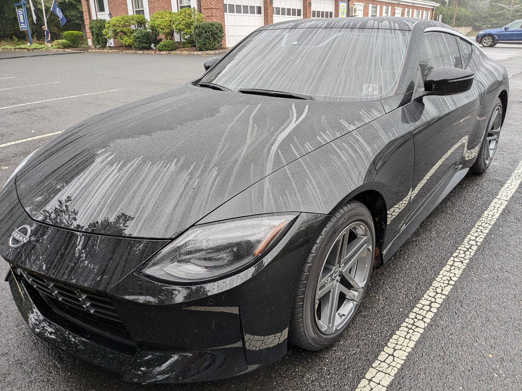

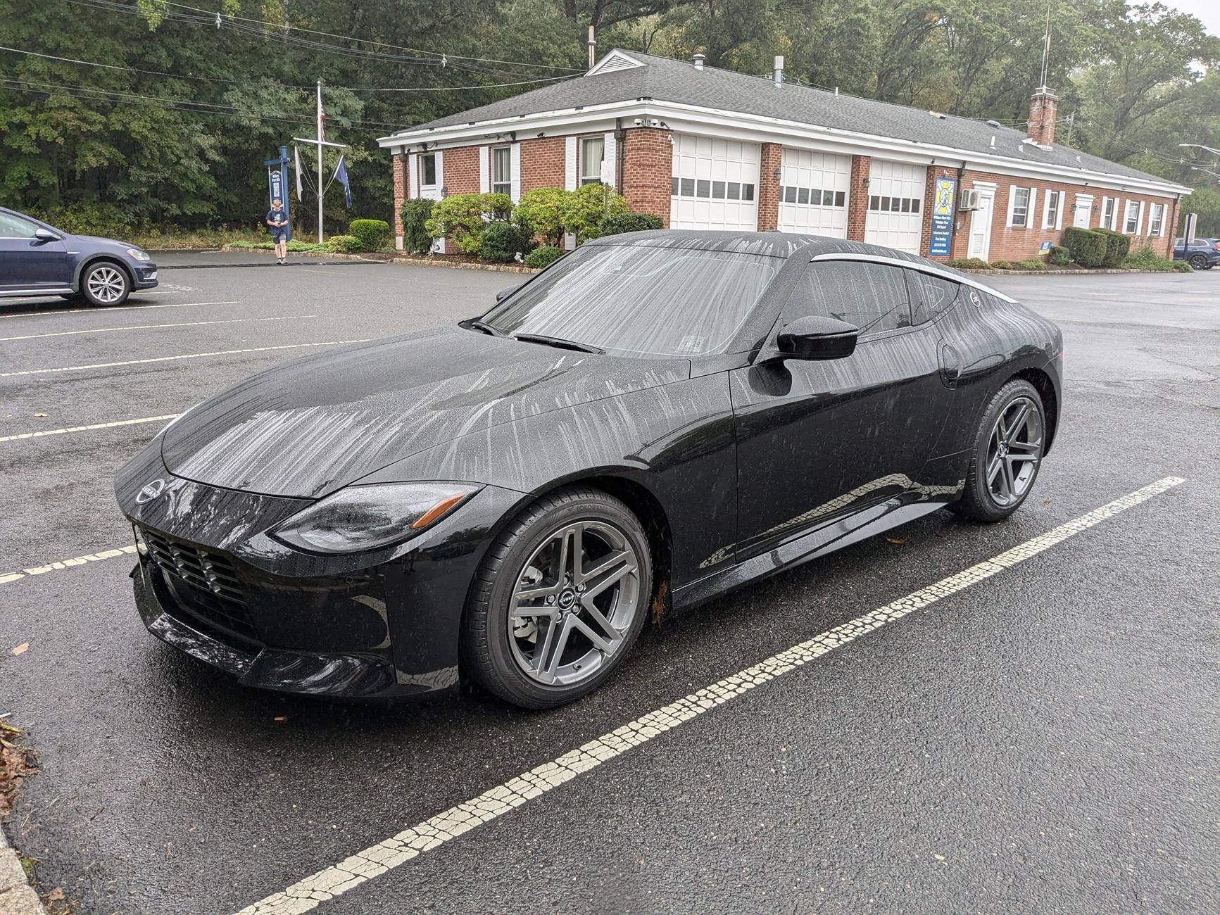

I calayed, then applied the green Meguiar's hybrid ceramic wax in April 2024. Car is always garaged. Never put away dirty. In September, wax was still performing well:

Wax wears out, but as the pics show, it is still beading like crazy. I'll keep the thread updated when I get to this.

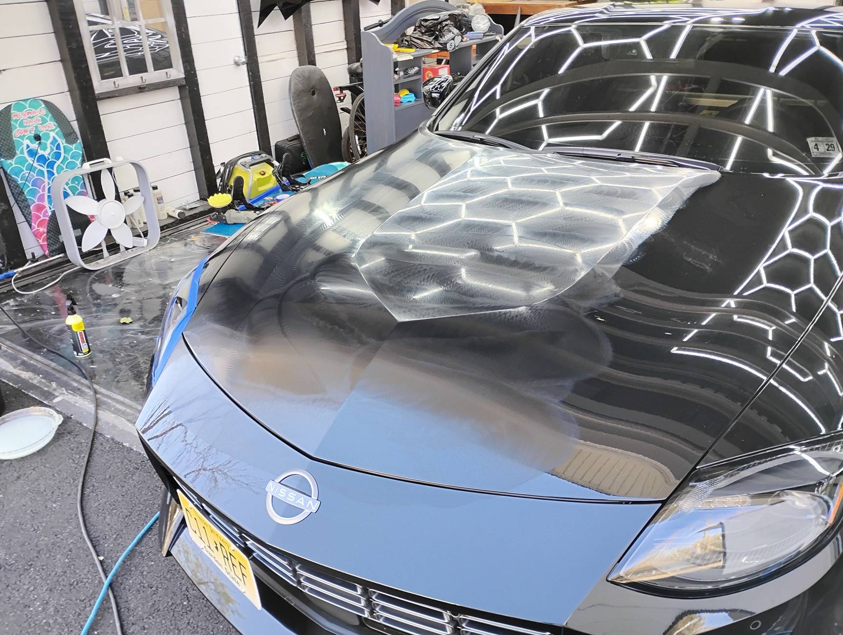

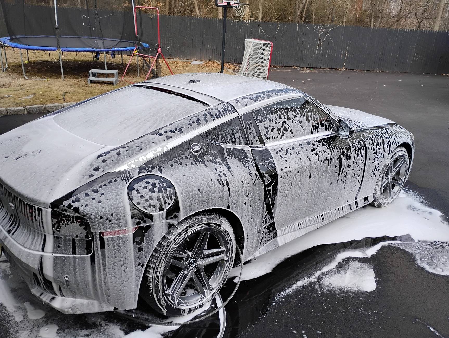

Foam with Dawn/soak/pressure wash. Re-foam and wash. De-iron. CMX to remove wax. Clay, polish with DIY Detail Gold Standard. Wipe down with CMX Wax remover to remove the oils from polishing. THEN, ceramic. Here's a pic of soap STICKING to a car that's wax has been killed.
The polishing was tedious. I had one spot where SOMEONE pre me-buying the car rubbed the paint. Big swirl. That came right out. Another piece that benefitted from polishing was the strip just above the 3rd brake light. I polished the rest, but can't see many benefits there. MAYBE they're a bit shinier. It was worth doing if before I super-seal in everything. I used "rinseless wash" in a pie pan, and an empty bucket. After polishing, I'd press my polishing pad in to the pie pan and "pump" wash through it. Then, I'd rev it up to 3rd setting in the empty bucket. Turn it of. While it was winding down, I'd do 1 squirt of the polish onto the pad.

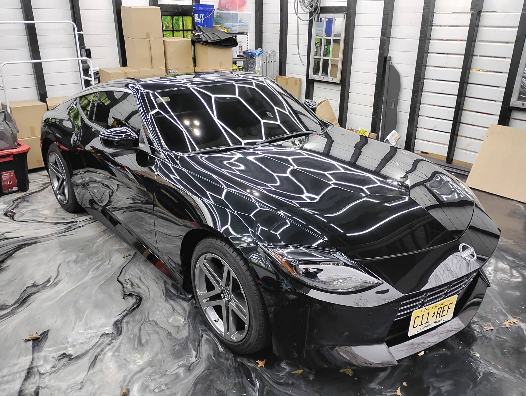

95% FINISHED ceramic coating the whole car today! What did I leave out? There are 2 tiny chips in the hood. Waiting on my touch-up paint. I'll fill them in THEN ceramic the hood.
Used ADAM'S GRAPHENE CERAMIC COATING SPRAY (Advanced). Went on great. Rainbowed up, but was a bit difficult to see. I planned on only doing painted surfaces. But, I got some on the trim and it looks INCREDIBLE. The trim and rubber I coated looks BRAND NEW. I did the glass with the Adam's ceramic stuff. HOLY $CHCRACKINS!!!!! It looks great!!
When I was done I remembered I bought a UV flashlight to check coverage. (This coating has UV tracers in it.) When I was done, I went over the car with the UV light. Some places were not as "glowy". Some looked as if there was a high spot because of streaking. In natural light though, there was no high spot.
