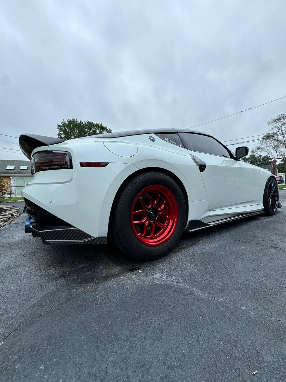

Hey so I have a 23’ performance 6mt
Rears I have MT et street SS 305/45/17
Weld laguna 17x10 25 offset / 6.5 back space
With no spacers fitment is perfect.
need help with front
Looking at weld laguna s107
18x8 off set 29 / 5.6 inch back space
Will this be a good fitment for front ?
which tire size would fit the fronts ? and which brand would be best.
- thank you

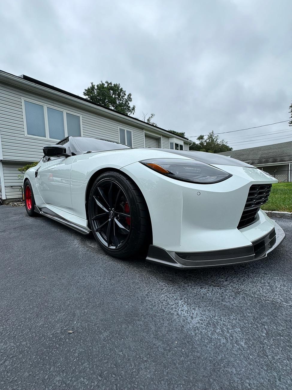

thanks for the info, I’m trying to do a skinny up front but not trynna go 18x5.
car is mainly for roll runs.
18x8 thinking of a 245/45/18 ? Or your expertise advice.
