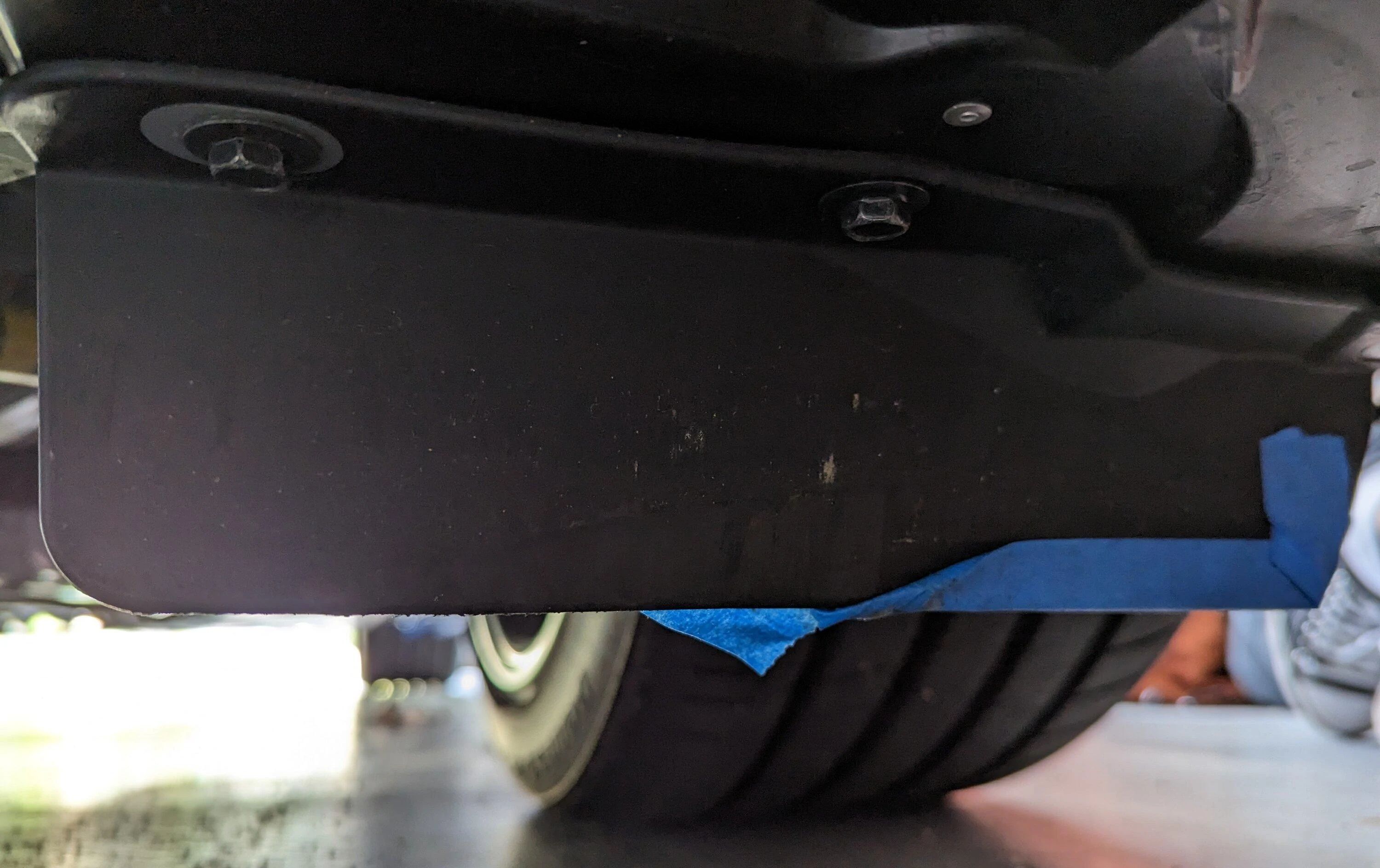

Ouch! One way to verify it would be to put some masking tape, like the 3M blue, on the place in question. If it ends up scuffed or torn, you’ll know for sure that’s the location.

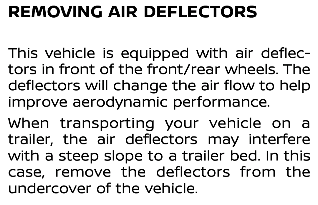

Yeah, the owner's manual also mentions removing the air deflectors if you have the car transported.
I like the masking tape idea, I'll give that a go.

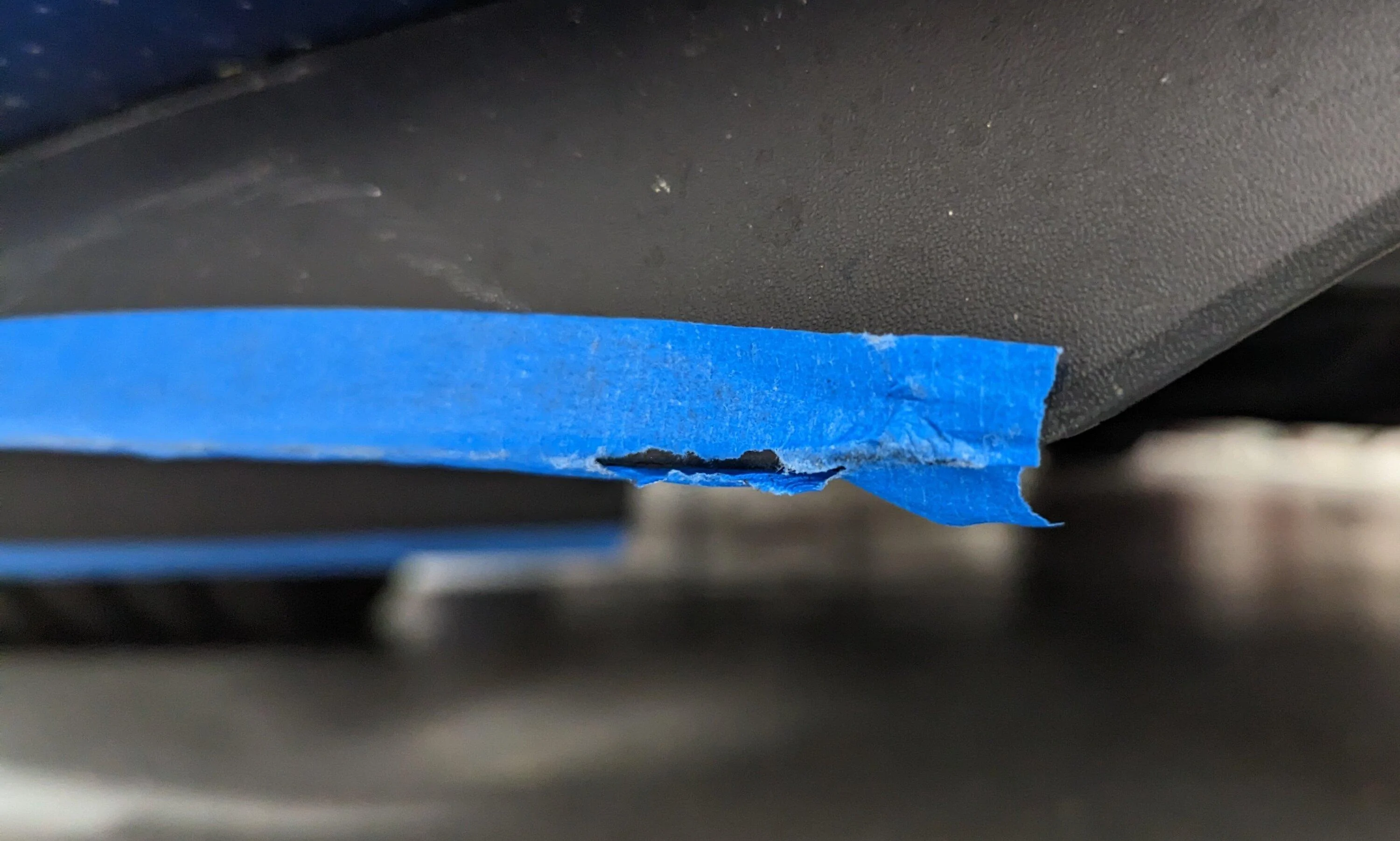

Results.
Driver side air deflector looks like had a big scrape. The chin spoiler unaffected.
Chin spoiler on the passenger side had a small scrape, but the air deflector in the background is unaffected.

Interesting. At least now we know the ā€œculprits,ā€ and as suspected. ;)
