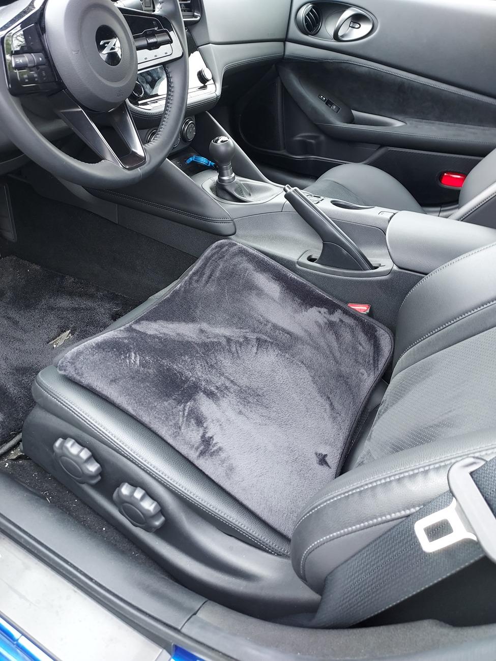

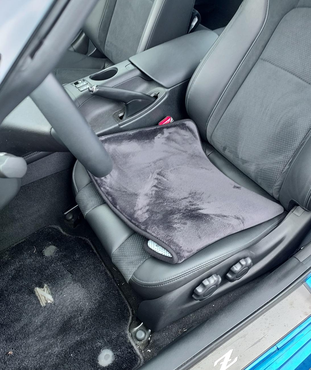

I have been okay with the seats since I got a memory foam mat to sit on. Not great, but cushions the metal and plastic on the base well.
I might try that myself, have an arthritic hip and usually after driving more than 45 minutes it starts throbbing, looks like the plastic base might be causing it?
Im a big guy (6"2" 225)and otherwise have plenty of legroom, headroom,sholder room

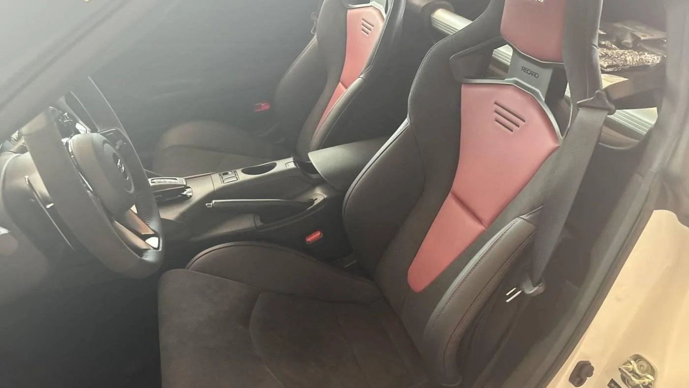

The Recaro's in the Nismo are extremely comfortable. Should be a easy swap. FYI they're not power seats, but still have excellent manual adjustments.
So what is the difference, if any, of these Nismo Recaros vs the 370Z V2 Recaros, mount-wise and electrical connections? My guess the mountings are identical but not sure of the wiring adaptability.

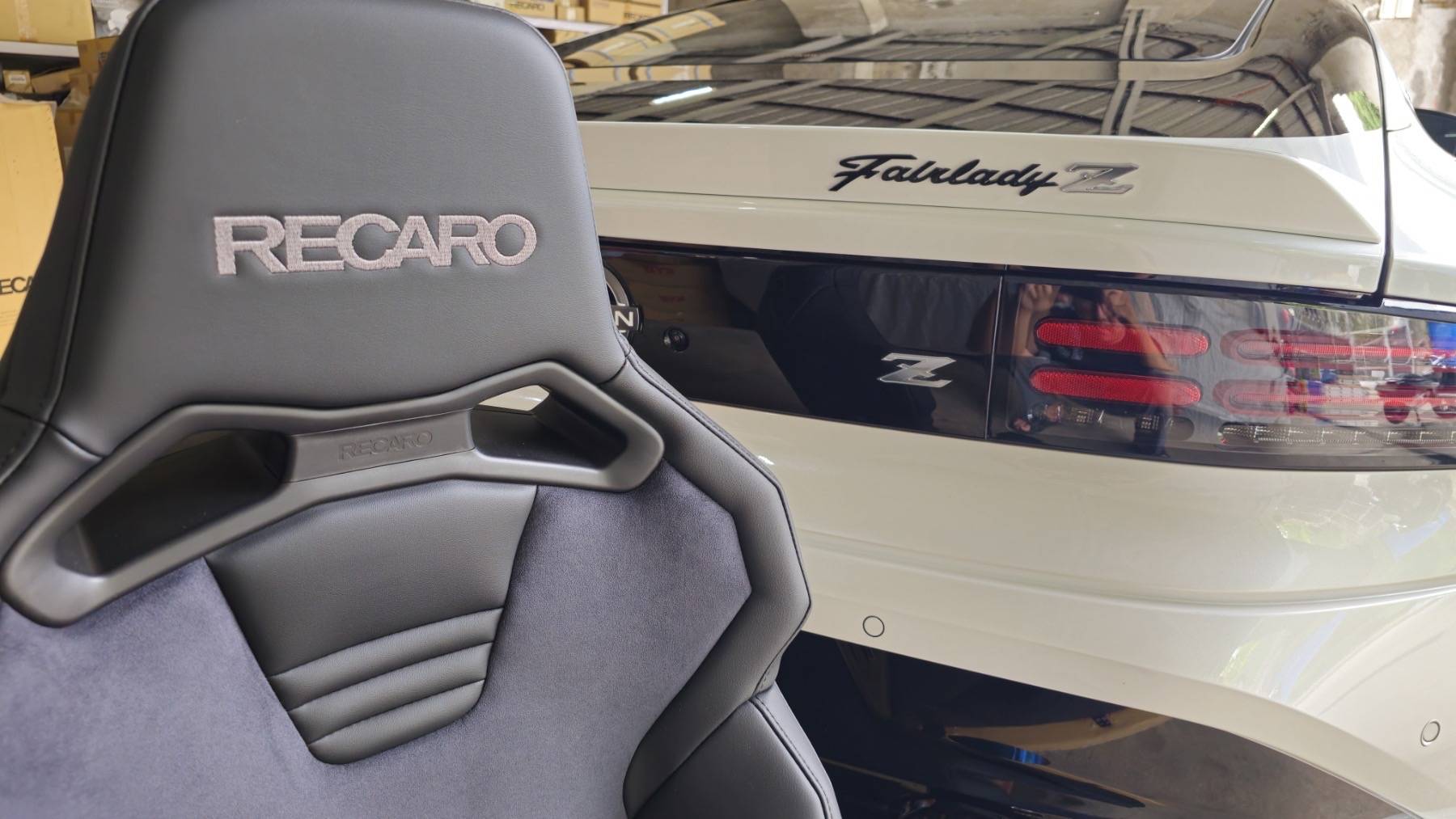

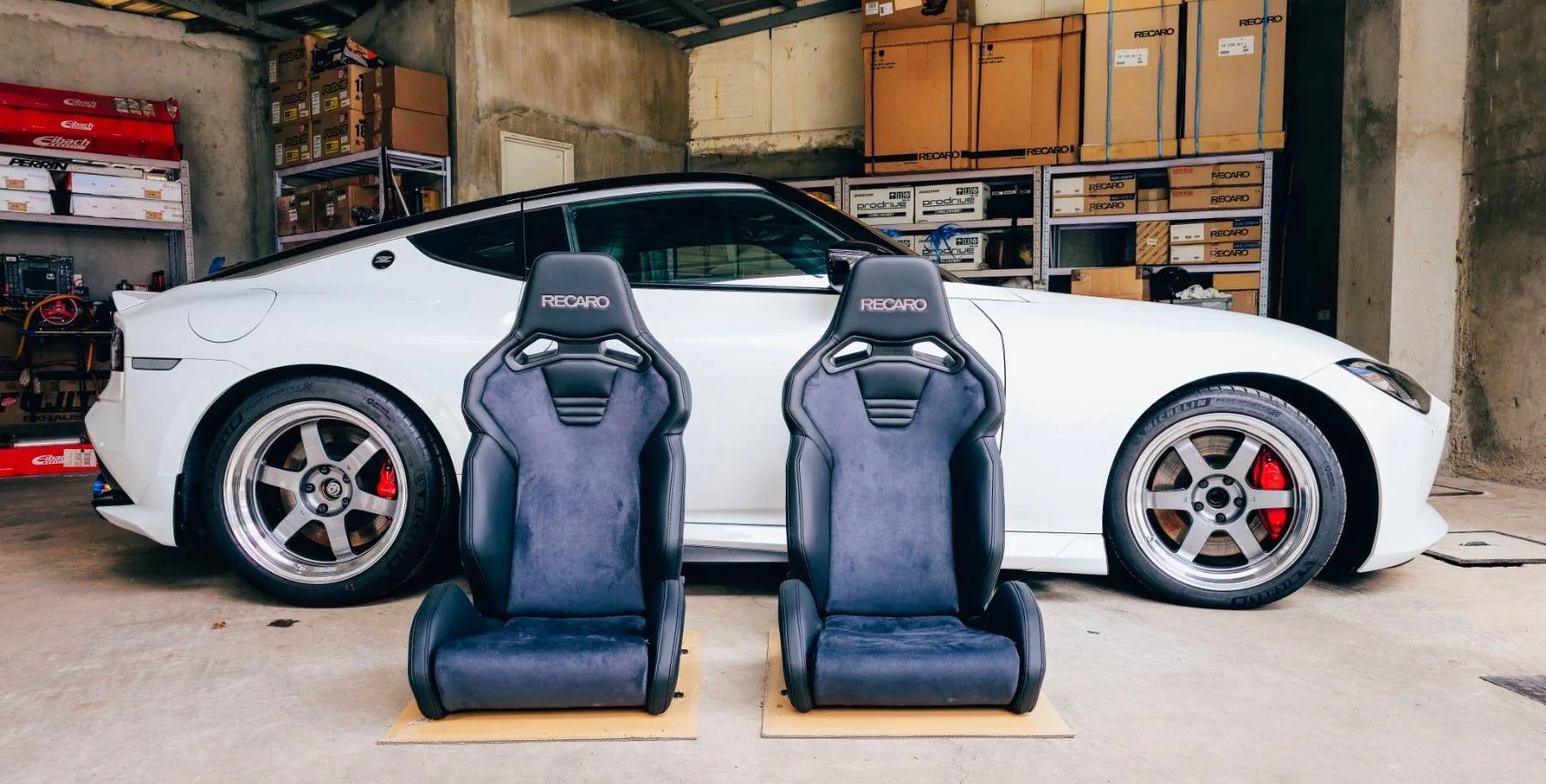

I replaced the stock seats from my Nissan Z Performance MT with Recaro SR-S. Feels very much OEM but way better driving position. Lumbar support is good with ample lateral bolsters for spirited driving. This new release Recaro SR-S were specifically designed for modern-day sports cars with low driving position such as the Nissan Z RZ34

Very nice... What did you do about the airbag connection? Resistor?
No need for additional resistor/relay. The Recaro baseframe already includes side airbag wire to cancel the stock one. You also need to attach the seat occupant sensor to the Recaro to avoid airbag warning 🙂
Quick question as you mentioned these seats are good for cars like this with a low driving position - do you mean that these maintain the low position or that they let you adjust it? My main issue with the stock seats in my proto Z seems to be that the seats are just too low and don't have any real height adjustment
Unfortunately, these don’t have height adjustment either. But it is a tad higher than stock, yet still maintains the low driving position.
