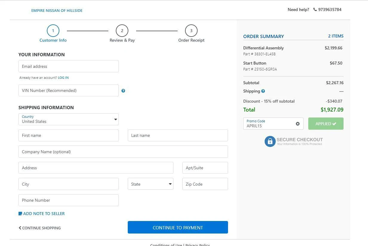

this car should not be offered with a peg leg option. however the traction control is a decent reactive solution. just not a fan of relying on traction control when there is a much better solution.
the good news is itā€™s an easy mod to fix.
