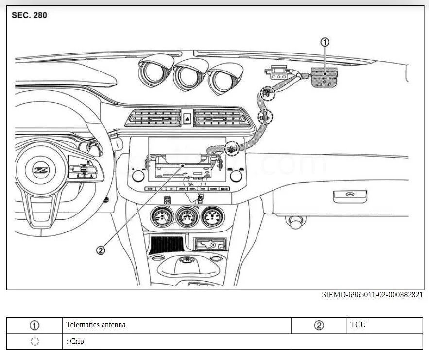

I found the telematics communication unit (TCU) location and its antenna. The telematics and GPS antennas share the same connection to the TCU. You can find this diagram on page 433 of this section of the service manual.

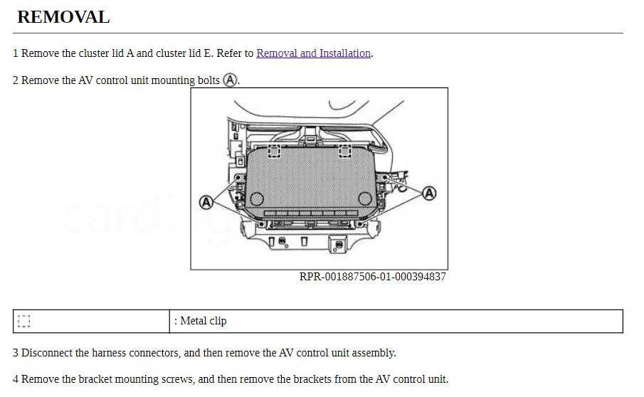

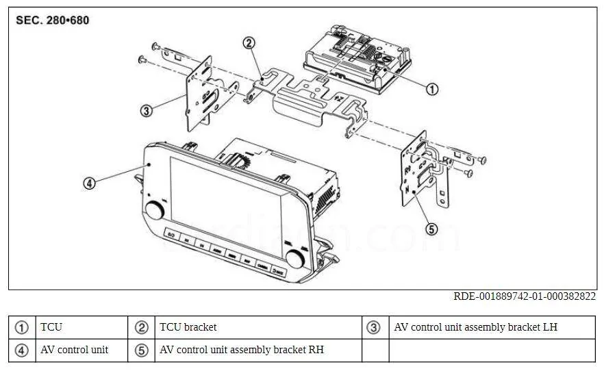

The AV unit must be completely removed from the dashboard to remove the TCU itself. They connect to each other by USB. The mounting method is the same for cars both with and without navigation (page 343).

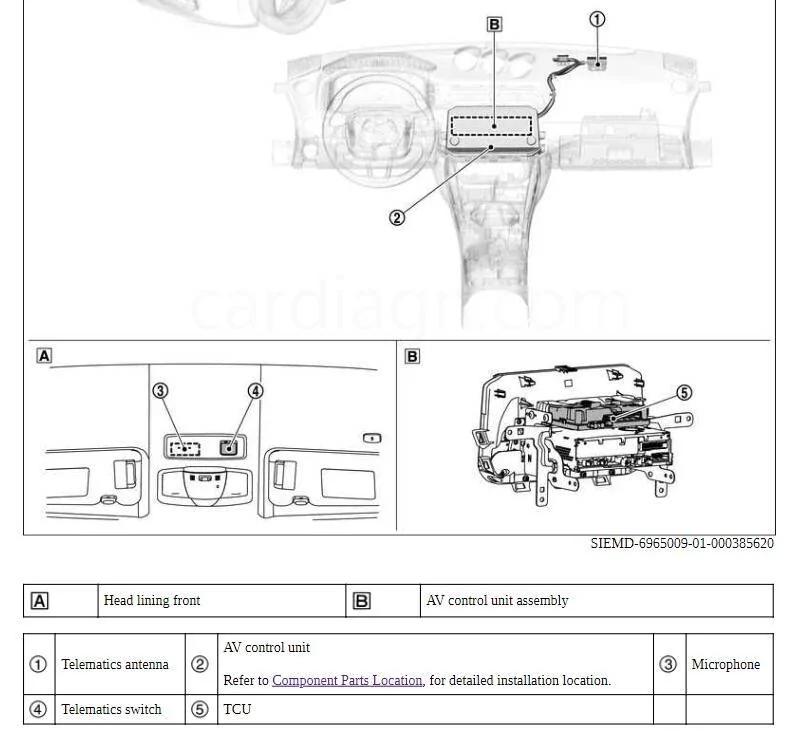

This is the routing of the TCU antenna cable to the TCU, found on page 438 of the same section. The plug to the TCU may be reachable by removing the glove box and the surrounding trim piece. Each half of the antenna is attached to the underside of the dashboard by one screw.

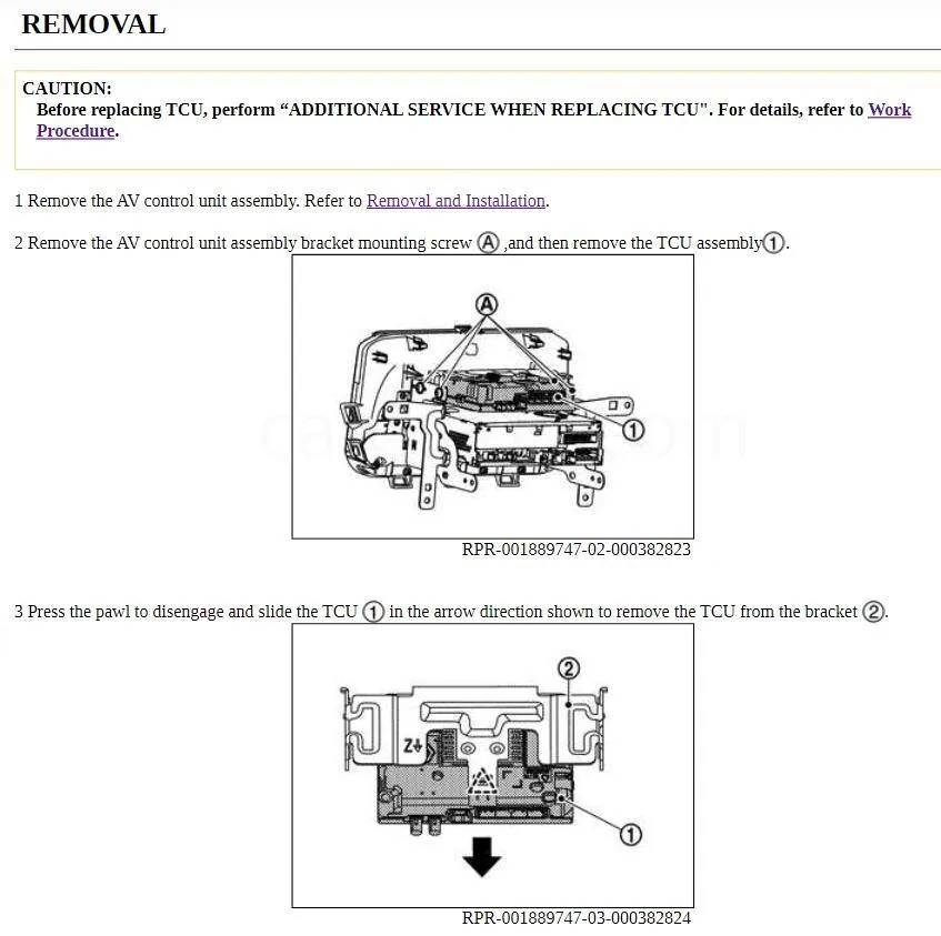

Additional removal instructions follow. The center air vents and lower trim around the AV unit must be removed first, as detailed in this section.
