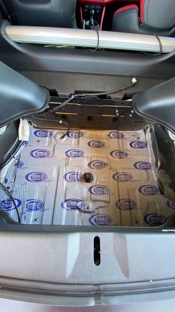

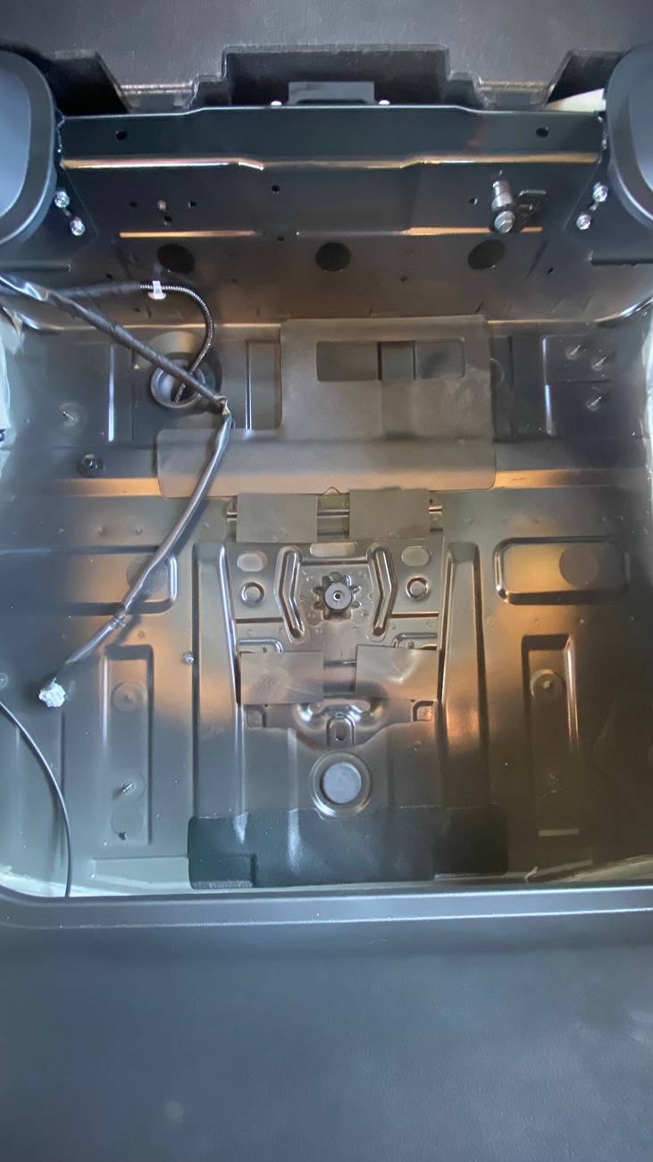

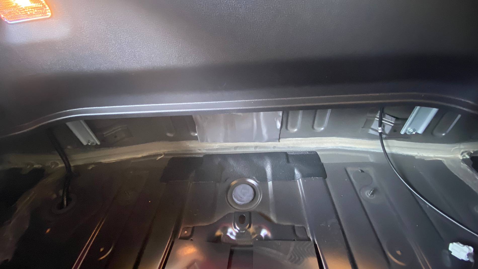

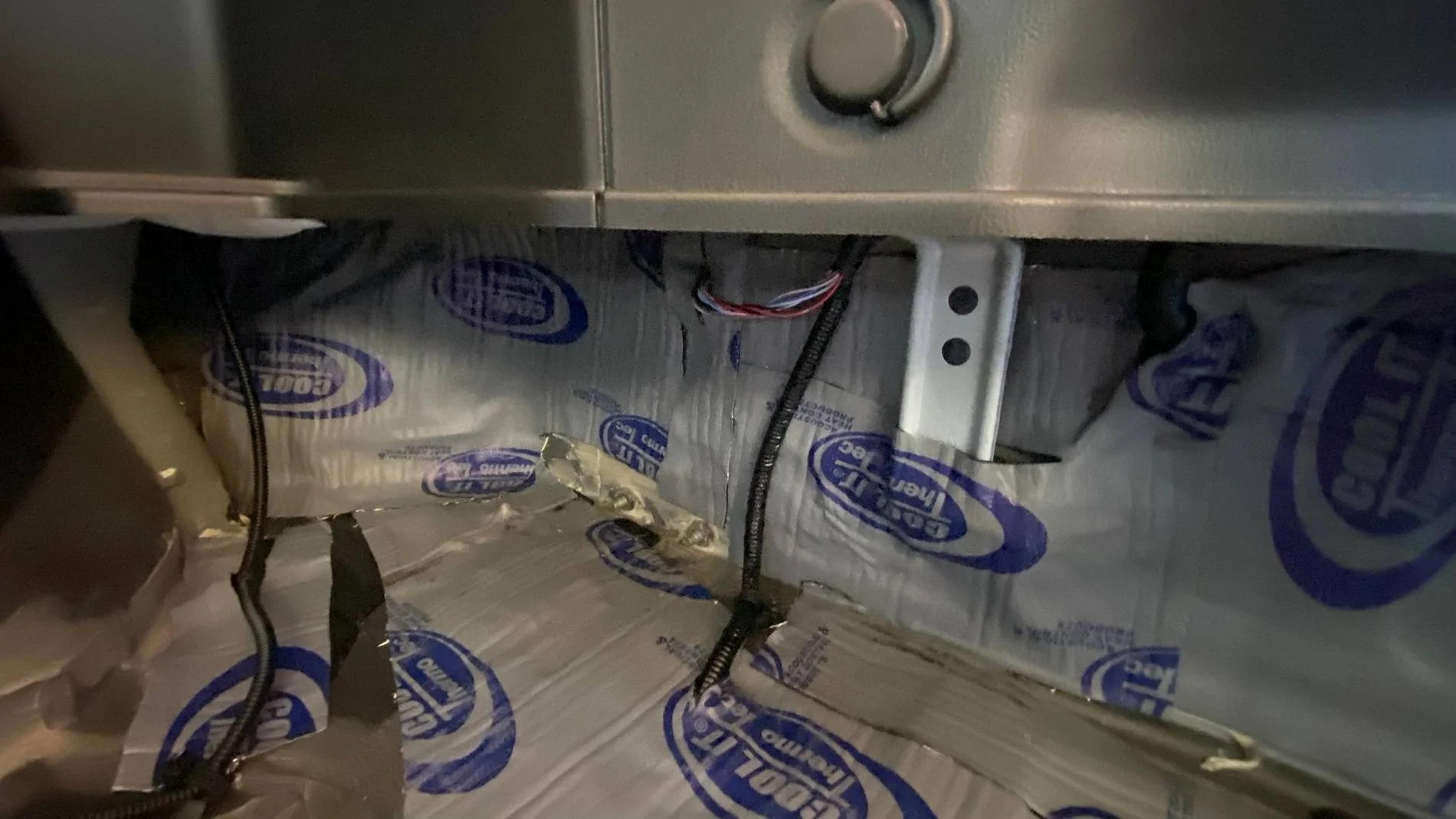

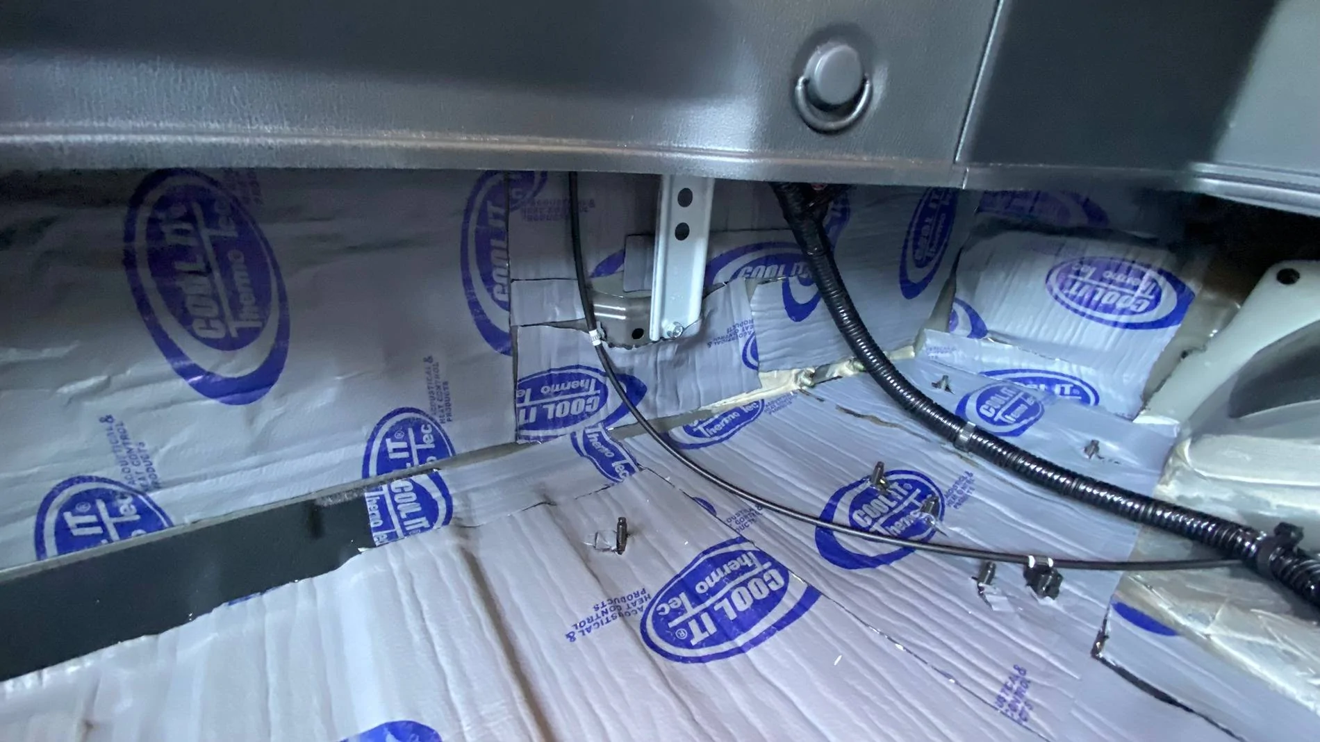

I don’t have the ability to measure dB, or rather maybe i do and it’s just not my strong suit…. That said, I did remove all the foam out of the back. It wasn’t hard, once you remove the sub with one simple hand screw or whatever you have in that spare tire spot (i have a performance trim) you just pull that middle foam section, then the L and R are held on by one single little plastic screw cap in the bottom of the foam. I removed the crap Bose subwoofer and have been in a holding pattern for almost two months waiting for a custom wiring harness to connect a new spare tire sub. I had all this sound deadener laying around from a jeep project a couple summers ago but you could really cover every tiny inch with some patience and not much $ at all.
This job, at least in the trunk area, has to be about a 1 out of 5 on a difficulty level so dont hesitate to give it a shot.
When I did mine it was sort of a “I‘ve got this all torn apart anyway, and i have this deadener, why not?“ it wasnt my main project. The ONLY hang up you may have is just how tight that foam can be under the left and right sides, but some gentle pursuading and you can do so without any damage. It’s foam after all, so dont go at it like the Hulk and you will be fine.
