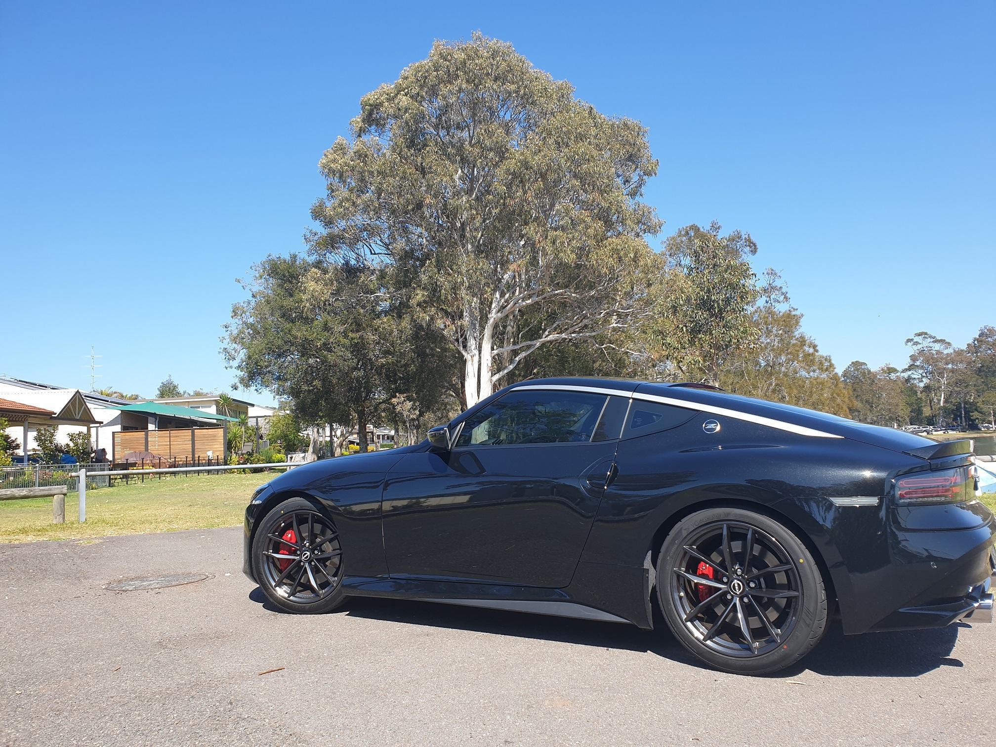

What did you do to achieve the 1" drop?
Installed height adjustable coilovers (mca sport comfort) The manufacturer recommended this ride height but its what I would have gone with regardless.
