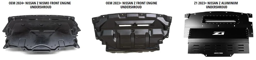

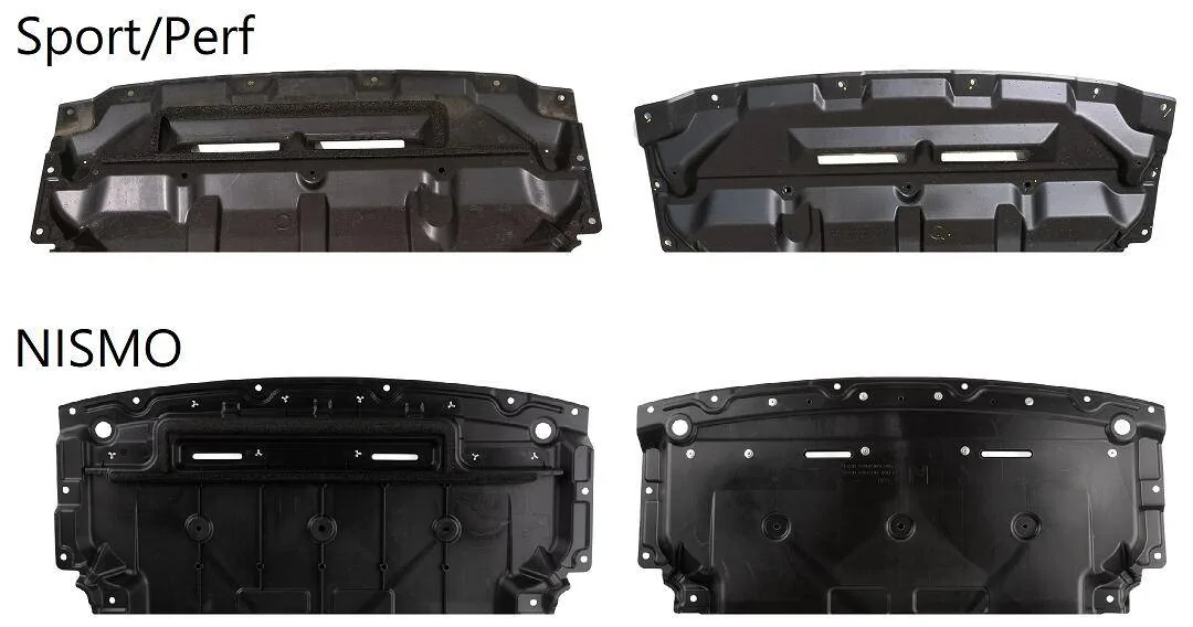

I occasionally like to do oil changes myself. For my first Z33 I modified the tray so I didn't have to remove it entirely. I was thinking the Z1 undertray ("undershroud") for the RZ34 would be a nice addition to allow me and whoever changes the oil easier access. I just found out the tray on the NISMO is different than the Perf/Sport, and Z1's description of their undertray says "Does not fit NISMO bumpers." I've read here that the Sport/Perf undertray has a bend point so you can remove only the rear fasteners and fold it out of the way (the line right below the vents?). The images of the OEM NISMO tray on Z1's website doesn't look like this is possible.
Anyone have experience with the NISMO undertray and changing the oil?
Does anyone else make an undertray like Z1's for the NISMO?

I installed the Z1 undershroud on my Nismo. It mostly bolts up, two of the outer bolts on the piece that bolts to the bumper didn't line up, but no one can see it so I didn't really care. No one makes a Nismo undershroud to my knowledge.

The Nismo under shroud doesn't have a vent for the oil cooler?
It's vented. Holes in the tray are much smaller on the NISMO.
